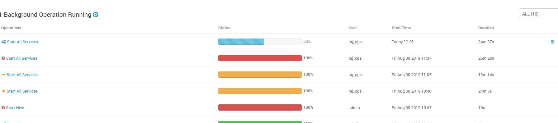

Since I am a novice in the Hadoop ecosystem and I have been trying to use the sandbox for HDP 3.0.1 in the past few days, the sandbox is behaving very strangely. In the beginning it used to work fine with all the services been started etc. just within a few minutes. However lately, the services most of the time fail to start or gets stuck at 55% or so for over an hour or even longer sometimes and still doesn't start. I have tried to uninstall and install again a couple of times but it doesn't help.

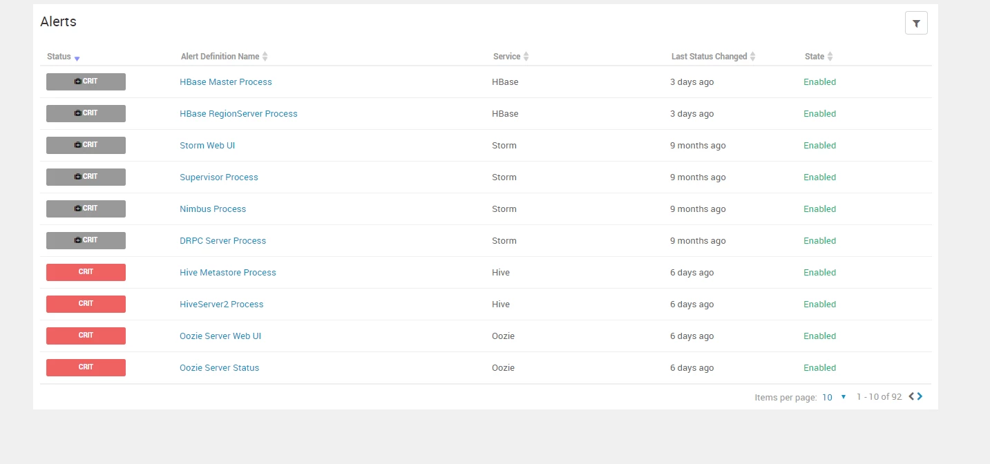

However when individually starting the services, some of them still fail like Hive Metastore, Zepplin for example. Is it also because of the lack of memory? Since let's say I need the following services to run at once, HBase, Hive, MapReduce, HDFS, dataAnalytics and Zepplin.

Also it will be great to start monitoring the free memory of the Sandbox host where all the components are running so that we will get better idea why the services are starting slow and taking almost 25 minutes time to start/fail to successfully start.
If you still find any failure in starting the selected services then please share the logs of those individual service components which are failing to start and also the "free -m" command output during the startup operation.
