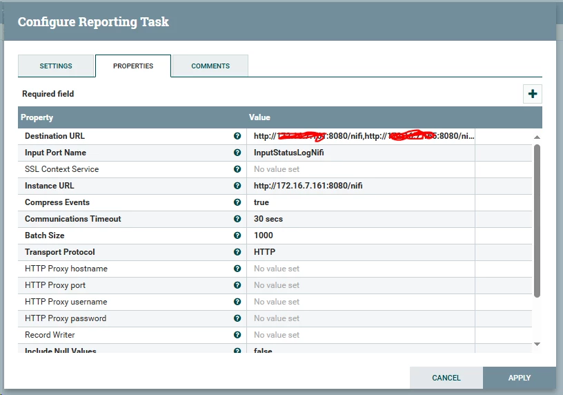

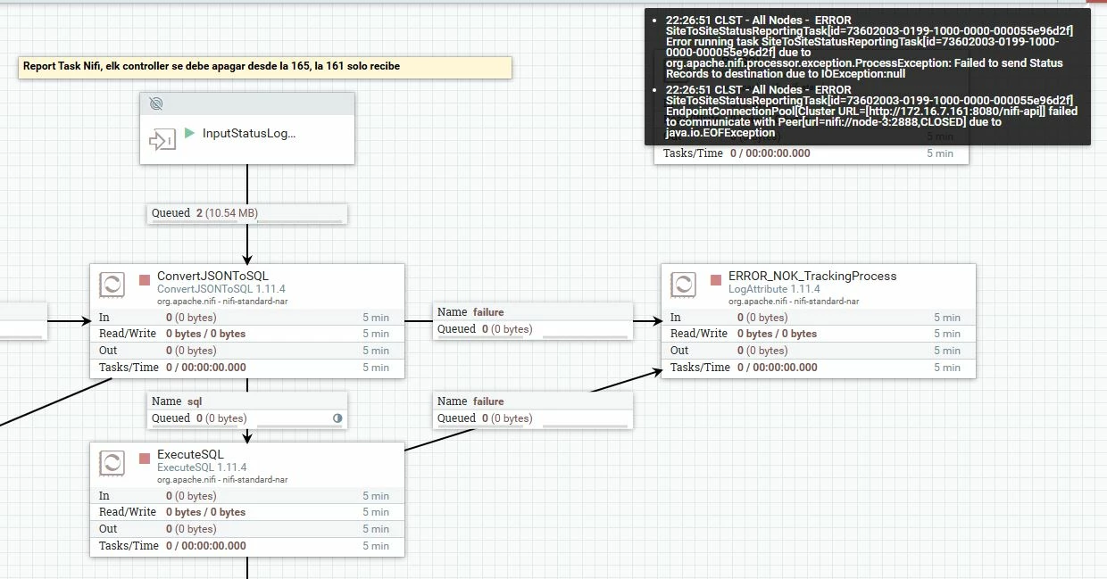

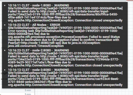

Please, I have a couple of questions. To put it in context, I need to capture only the flows that are running with errors, and I'm wondering how or what the recommended configuration would be for configuring the Site-to-Site Status Reporting Task controller for a 3-node cluster. As it is, it generates a lot of error messages and fills up my disk. Therefore, I want to suppress those messages with the correct configuration.
node-1:8080SiteToSiteStatusReportingTask[id=743817f2-0199-1000-0000-000026cab202] EndpointConnectionPool[Cluster URL=[http://172.16.7.xxx:8080/nifi-api]] failed to communicate with Peer[url=nifi://node-3:2888,CLOSED] due to java.io.EOFException
node-2:8080SiteToSiteStatusReportingTask[id=743817f2-0199-1000-0000-000026cab202] EndpointConnectionPool[Cluster URL=[http://172.16.7.xxx:8080/nifi-api]] failed to communicate with Peer[url=nifi://node-3:2888,CLOSED] due to java.io.EOFException
All NodesSiteToSiteStatusReportingTask[id=743817f2-0199-1000-0000-000026cab202] Error running task SiteToSiteStatusReportingTask[id=743817f2-0199-1000-0000-000026cab202] due to org.apache.nifi.processor.exception.ProcessException: Failed to send Status Records to destination due to IOException:null

The exceptions you shared are bulletins only and always being reported as issue sending to http://node-1:8080/  node. I see all your other configuration are based off IPs.  Are all you NiFi nodes able to properly resolve "node-1" to the correct IP address?

Back to this, again very very grateful, I made the suggested changes regarding the definition of the s2s urls, Yes, the nodes resolve well by node-1, node-2, node-3, the issue with the s2s messages is that they reach the log and fill up the disk, I have budget limitations in technology, I can not allow it to increase, then my nifi falls by disk, therefore I have maintenance shells that run every day to maintain disk usage, I checked and indeed the 2 controllers, the s2sbolletin and the s2s status, work for me, they will remain in different tables, I made the changes, I was confused with the formats regarding one with the other, thank you very much Matt
