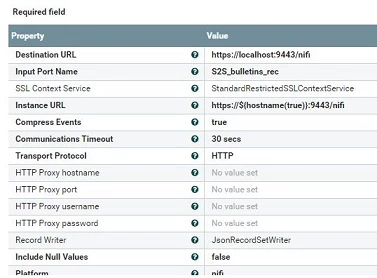

I have SiteToSiteBulletinReportingTask setup to capture bulletin information for a standalone secure nifi instance. the reporting task is pointing to an input port as expected but when I start the task it doesnt work and it keeps giving this warning:
SiteToSiteBulletinReportingTask[id=e99b03f1-0173-1000-c7ef-4e475ed2416d] org.apache.nifi.remote.client.PeerSelector@24677b11 Unable to refresh Remote Group's peers due to response code 403:Forbidden with explanation: null"
The reporting task is setup as follows:
The SSL context service is setup with the same values for the keystore and truststore as in the nifi.properties file which is working to secure my instance.
I have added the policy "receive data via site-to-site" to the input port "S2S_Bulletins_rec" .
The user created by securing the instance has the policy "retrieve site-to-site details".
The error doesn't give much details. Can you please help? Thank you.

Hi Matt,
Thank you very much for taking the time and explaining how this process works. I spent a lot of time trying to troubleshoot the issue and I think I was able to resolve. what caught my eye in other similar post is the case of DN being authenticated and authorized which what you also highlighted "...which means the DN form that clientAuth certificate is going to be the user that needs to be authorized for both the "retrieve Site-To-Site details" and "receive data via site-to-site" NiFi authorization policies". Im not a security expert here but I assume DN refers to Domain, right? In any case for me to resolve this issue I had to do the following:
1- In the "SiteToSiteBulletinReportingTask" properties I kept the default value for "Instance URL" which is "http://${hostname(true)}:8080/nifi" despite my nifi instance is being secured. Im stil not very clear what this value is for and the tutorial doesnt give much info on and I always thought it has to match what is set for the Destination URL but its not.
2- In Nifi I have added the user "CN=localhost , OU=NIFI" and made sure to give it all kind of permission including view & modify data. Im thinking since my domain is "locahost" and the domain "DN" is what is being authenticated\authorized I needed to create this user account.
3- In the nifi.properties file I made sure the following properties are set as follows:
         nifi.remote.input.host=
         nifi.remote.input.secure=
         nifi.remote.input.socket.port=8080
         nifi.remote.input.http.enabled=true
    If I set the "nifi.remote.input.secure" to true then I will keep getting 403 Forbidden error  despite my instance is secured!
Not sure if all of the above helped or combination of it but at least its working and I'm able to replicate playing with those parameters. Im hoping someone from the Nifi community can maybe elaborate more on this to confirm as Im not a security expert. Thank you.
