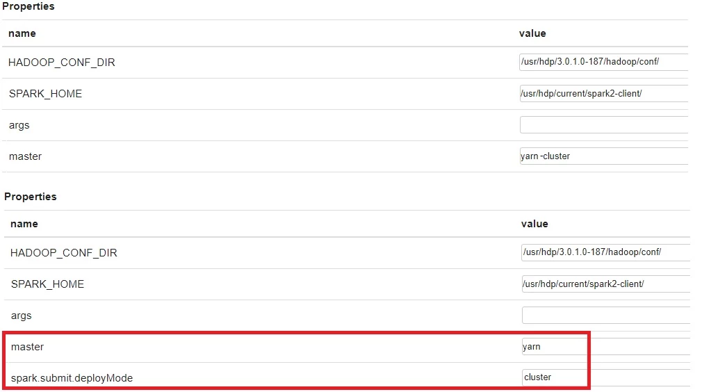

Indeed it works after tweaking zeppelin's spark interpreter parameters
and changing:
master: yarn-cluster
to
master: yarn
spark.submit.deployMode: cluster
