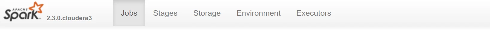

Hi,
I am trying to run spark streaming job on cloudera v5.14.4 which will be reading data from kafka v0.10. I am using following version of spark streaming dependencies
spark-streaming_2.11:2.3.0
spark-streaming-kafka-0-10_2.11:2.3.0
The job works fine on local but on cloudera it is not starting up. There is no streaming tab on AM and stages/storage tabs are blank.
There are no errors in the logs. Any suggestion what might be wrong here?

Thanks for replying. I created a simple word count job and I'm running it using this command
SPARK_KAFKA_VERSION=0.10 /opt/cloudera/parcels/SPARK2/bin/spark2-submit --num-executors 2 --master local[4] --driver-java-options "-Djava.security.auth.login.config=/apps/raiot/dev/confluent/config/jaas.conf" --class com.cloudera.spark.examples.DirectKafkaWordCount --conf "spark.executor.extraJavaOptions=-Djava.security.auth.login.config=/apps/raiot/dev/confluent/config/jaas.conf" spark-dstream-secure-kafka-app-1.0-SNAPSHOT-jar-with-dependencies.jar
Here are the logs
