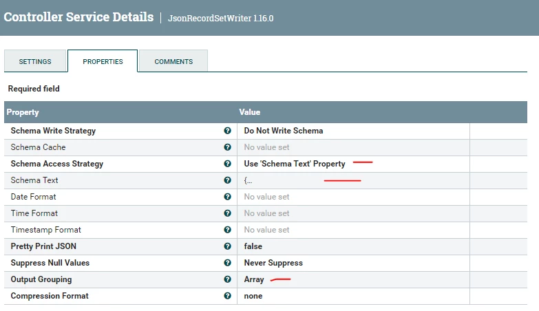

If you are able to do the jolt transformation to have the out put as specified above then in the ForkRecord ReocrdWriter should be set to "JsonRecordWriter" and the JsonRecordWriter can be set as follows:
The Schema Text property can be set to the following:
"type": "record",
"name": "TestObject",
"namespace": "ca.dataedu",
"fields": [{
"name": "NestedKey1",
"type": ["null", "string"],
"default": null
"name": "NestedKey3",
"default": null
"name": "NestedKey2",
"default": null
This should give you the desired output you specified above.
