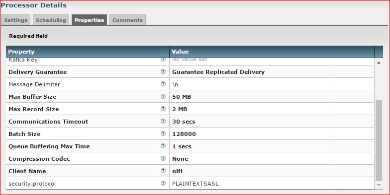

The PutKafka processor looks like:
and the zookeeper-jaas.conf looks like ("REALM" has been replaced):

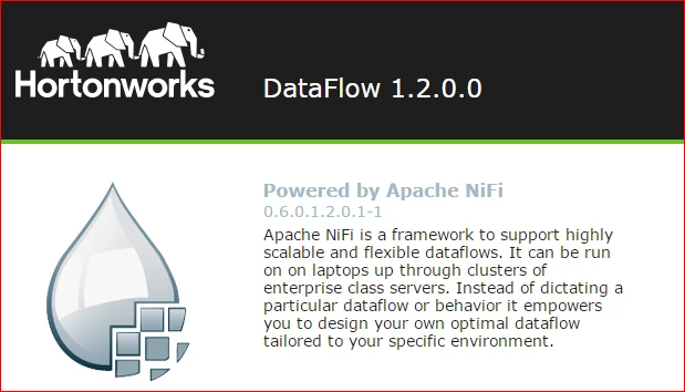

There are two versions in play here:
- HDF which is the stack from Hortonworks containing NiFi but not only (Kafka, Storm, ZK, ...).
- Apache NiFi which is the release from the Apache community
You are using HDF 1.2.0.1 which contains NiFi 0.6.0 + patches.
Last week, HDF 2.0.0 has been released and is containing NiFi 1.0.0 + patches.
As you can see, the NiFi release contained in HDP release can come with early patches to help users for a better integration.
Translate

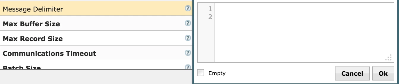

@Gerd Koenig
Can you try changing the value you have for "Message Delimiter" from "\n" to an actual new line in your PutKafka processor?
You can add a new line by holding the Shift key while hitting enter.
The result will appear as below:
Thanks,
Matt

geko
gekoAuthor
Gold ⭐️
Sep 21, 2016 2:02 PM UTC
Hello @mclark ,
thanks for explaining the versioning topic. Although it is a bit 'complex', if I interpret it correctly my combination of HDP 2.3.4 and NiFi0.6 (extracted from HDF1.2) should work, means the PutKafka should be able to write to kerberized Kafka0.9 with PLAINTEXTSASL.
Unfortunately it is not, even after I modified the "Message Delimiter", either to 'new line' or to 'not set'.
Just to ensure, the NiFi welcome page shows "Hortonworks Data Flow .... powered by Apache NiFi", the 'about' dialog is the one I pasted in this thread above, and the whole NiFi directory from where I start it has been extracted from HDF-1.2.0.1-1.tar.gz. Therefore I am pretty sure I am runnign HDF version of NiFi...
What can I check further ?
Thanks in advance....
