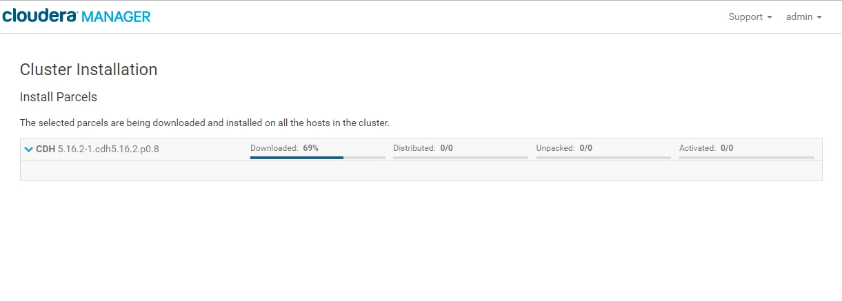

Stuck on Cloud manager parcel instalation
Hello,
Good afternoon.
I am new in cluster. I am installing CDH 5.16.2-1.cdh5.16.2.p0.8. I am stuck in here
I am check scm-server log using "tail -f /var/log/cloudera-scm-server/cloudera-scm-server.log"
I get this log
ID '798f1ee7-be79-475c-bc30-28573451693e' that is not recognized
2019-10-03 11:48:43,218 INFO ParcelUpdateService:com.cloudera.parcel.components.LocalParcelManagerImpl: (27 skipped) Found files KUDU-1.4.0-1.cdh5.12.2.p0.8-el7.parcel,CDH-6.2.0-1.cdh6.2.0.p0.967373-el7.parcel,CDH-5.16.2-1.cdh5.16.2.p0.8-el7.parcel,CDH-6.2.0-1.cdh6.2.0.p0.967373-bionic.parcel under /opt/cloudera/parcel-repo
2019-10-03 11:48:52,417 INFO ParcelUpdateService:com.cloudera.parcel.components.LocalParcelManagerImpl: Discovered parcel on CM server: CDH-5.16.2-1.cdh5.16.2.p0.8-el7.parcel
2019-10-03 11:48:52,417 WARN ParcelUpdateService:com.cloudera.cmf.persist.ReadWriteDatabaseTaskCallable: Error while executing CmfEntityManager task
java.lang.IllegalArgumentException: Unknown Distro suffix: bionic
at com.cloudera.cmf.CDHResources$Distro.valueOfSuffix(CDHResources.java:117)
at com.cloudera.parcel.ParcelIdentity.filenameInternal(ParcelIdentity.java:112)
at com.cloudera.parcel.ParcelIdentity.filename(ParcelIdentity.java:133)
at com.cloudera.parcel.ParcelIdentity$1.compare(ParcelIdentity.java:37)
at com.cloudera.parcel.ParcelIdentity$1.compare(ParcelIdentity.java:34)
at java.util.TimSort.countRunAndMakeAscending(TimSort.java:355)
at java.util.TimSort.sort(TimSort.java:220)
at java.util.Arrays.sort(Arrays.java:1512)
at java.util.ArrayList.sort(ArrayList.java:1462)
at java.util.Collections.sort(Collections.java:177)
at com.cloudera.parcel.components.LocalParcelManagerImpl.scanRepo(LocalParcelManagerImpl.java:143)
at com.cloudera.parcel.components.LocalParcelManagerImpl$1.run(LocalParcelManagerImpl.java:161)
at com.cloudera.parcel.components.LocalParcelManagerImpl$1.run(LocalParcelManagerImpl.java:158)
at com.cloudera.cmf.persist.ReadWriteDatabaseTaskCallable.call(ReadWriteDatabaseTaskCallable.java:36)
at java.util.concurrent.FutureTask.run(FutureTask.java:266)
at java.util.concurrent.ThreadPoolExecutor.runWorker(ThreadPoolExecutor.java:1149)
at java.util.concurrent.ThreadPoolExecutor$Worker.run(ThreadPoolExecutor.java:624)
at java.lang.Thread.run(Thread.java:748)
2019-10-03 11:48:52,423 INFO ParcelUpdateService:com.cloudera.parcel.components.ParcelManagerImpl: Downloading parcels of CDH:5.16.2-1.cdh5.16.2.p0.8 for distros [RHEL7]

@pramana ,
Looks like that you are using Ubuntu "bionic", which is not supported in CDH/CM 5.16.x, Bionic is only supported from CDH 6.2 onwards.
https://docs.cloudera.com/documentation/enterprise/release-notes/topics/rn_consolidated_pcm.html#c516_supported_os
https://docs.cloudera.com/documentation/enterprise/6/release-notes/topics/rg_os_requirements.html#c63_supported_os
So you need to either try 6.2 version of CM/CDH, or change the version of your Ubuntu OS.
Hope that helps.
Cheers
Eric
