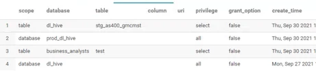

Verify and you can provide the output for below command:
a. show grant role role_test;
Outcome:
Additional info:
Login as testuser and query "show current role", no data is returned.
