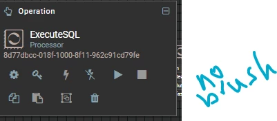

3- One thing I noticed quickly under the new UI because I wanted to reset the color theme on the processor from the step above but I could not find the brush icon anywhere! I'm not sure if that was removed intentionally or its done differently but I could find it anywhere. Even for the notes which you would be able to see using right menu click but its no longer there as well.
It appears if you have some color theme applied to the processors or notes in the old UI you probably cant change that unless Im missing something.

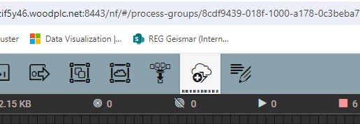

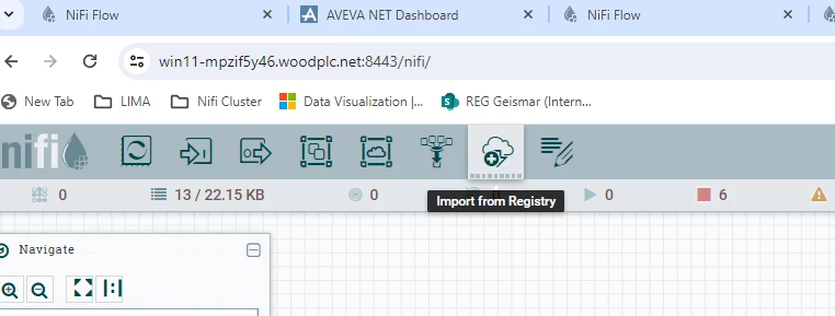

4- In the UI I noticed when you hover over any control button wither in the Operate Panel or in the Component Tool bar there is no label showing up. I found this is strange and I hope this is a bug of some sort and those labels are not removed because they were helpful specially for beginners. I got the same result in chrome, edge and firefox
Old (Label is Showing)
New: (Label is not showing)

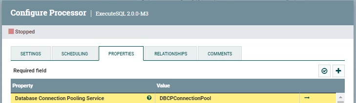

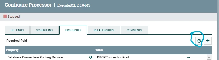

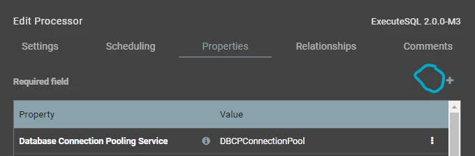

5- Under the new UI,  I no longer find the Validate processor icon when viewing a given processor properties. Again Im not sure if it was moved to somewhere else or removed completely which I hope not because it was a good feature to have.
Old (Validation Option)
New (No Validation Option)

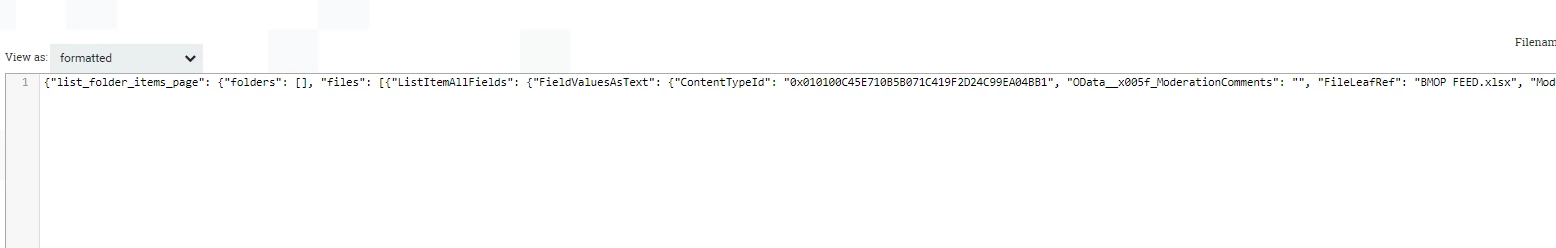

7- For some reason the dark theme is not being applied when viewing the flowfile content as I was seeing this:

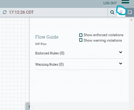

8- In the new version using the legacy UI if you want to call it , I noticed something new which Im not sure what it's used for yet , there is light bulb icon between the search and the home icon , when its clicked it brings panel to the right as the following:
This is not present under the new UI:

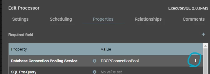

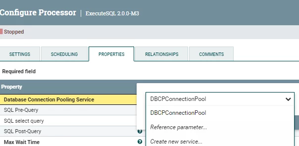

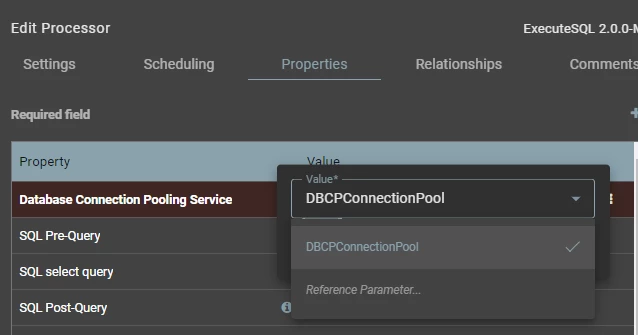

9- I can see some improvement in the new UI but I also see things that I'm not sure its a success, for example before under a given  processor properties where  there is a property to create a service you used to click on the property and you would see Create New Service as one of the options in the drop down , now you have to go to the three dots to the right (...) and click there to Create New service which is not intuitive in my opinion. Same thing if you want to go to  configure the service where before it used to be a visible arrow , but now its under the (...). This applies also to managing flowfile in the list queue view , and managing the control service where instead of visible controls next to the service (enable, disable, delete..etc.)  now everything is wrapped up under three dots (...) which means additional click.
New ( No option to create service in the dropdwon, click on ... to configure and create service) means additional clicks
Old: ( create service in the drop down and straight forward arrow to configure)

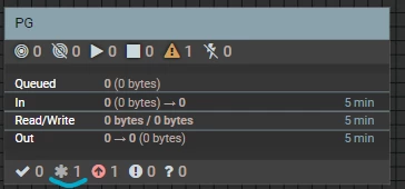

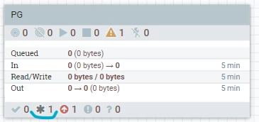

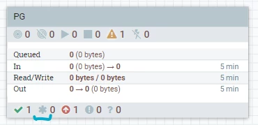

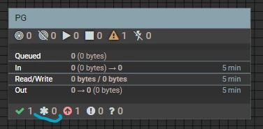

10 - I guess some of the color contrast can be worked on under the new UI ( light or dark) because its not  as clear as in the legacy UI. For example when the parent group is showing number of modified sub groups for versioning, going from 0 to N the contrast of the icon in legacy stands out more  to me:
Old (No Modified Sub groups) :
Old ( some modified sub groups)
Notice how the color of the icon changed form light to dark. However in the new UI
New ( No modifications )
New ( After modifications)
I think it went from lighter to darker (similar to legacy) so its not standing out, it should be reversed in my opinion where it goes from darker to lighter.
