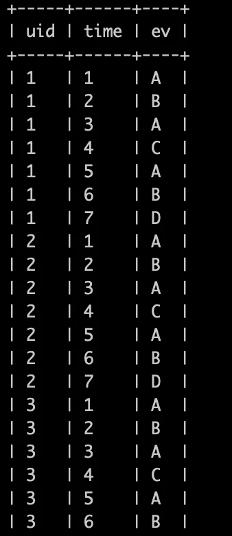

The structure of the table:
CREATE TABLE default.impala_udf_test (
uid STRING,
time STRING,
ev STRING )
WITH SERDEPROPERTIES ('serialization.format'='1')
STORED AS PARQUET
data of the table:
