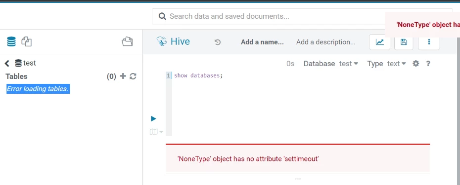

it started showing the databases after making above configurations but its not showing me tables and giving me the following error as shown in below screenshot:
  • 'NoneType' object has no attribute 'settimeout'

@hxn It seems like hive on Tez service is not up. Please go through Hive on Tez logs, and you should see more info around the error 'Error stopping schq'. We need to bring Hive service up first, and then we can approach the Hue issue, or Hue might start working after fixing Hive.

@hxn We should not have any hiveserver2 under "Hive" service.
hiveserver2 should be present only under "Hive on Tez".
If you have a hiveserver2 instance under "Hive" service, please delete it.
