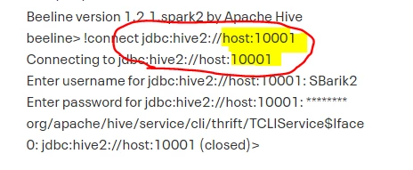

unable to connect thrift server using beeline
when am connecting to thrift server using beeline it's showing  below error
Beeline version 1.2.1.spark2 by Apache Hive
beeline> !connect jdbc:hive2://host:10000
Connecting to jdbc:hive2://host:10000
Enter username for jdbc:hive2://host:10000: admin-sbarik2
Enter password for jdbc:hive2://host:10000: ********
org/apache/hive/service/cli/thrift/TCLIService$Iface
0: jdbc:hive2://host:10000 (closed)>
it's automatically closed.

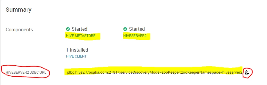

Following from my previous responses  can you get the connection string like below
Ambari UI --> Hive --> Summary (Tab) --> "HiveServer2 JDBC URL" --> Click on the at the right side of the URL to copy the URL and then try this URL with beeline once
At the prompt add beeline to the copied link above.

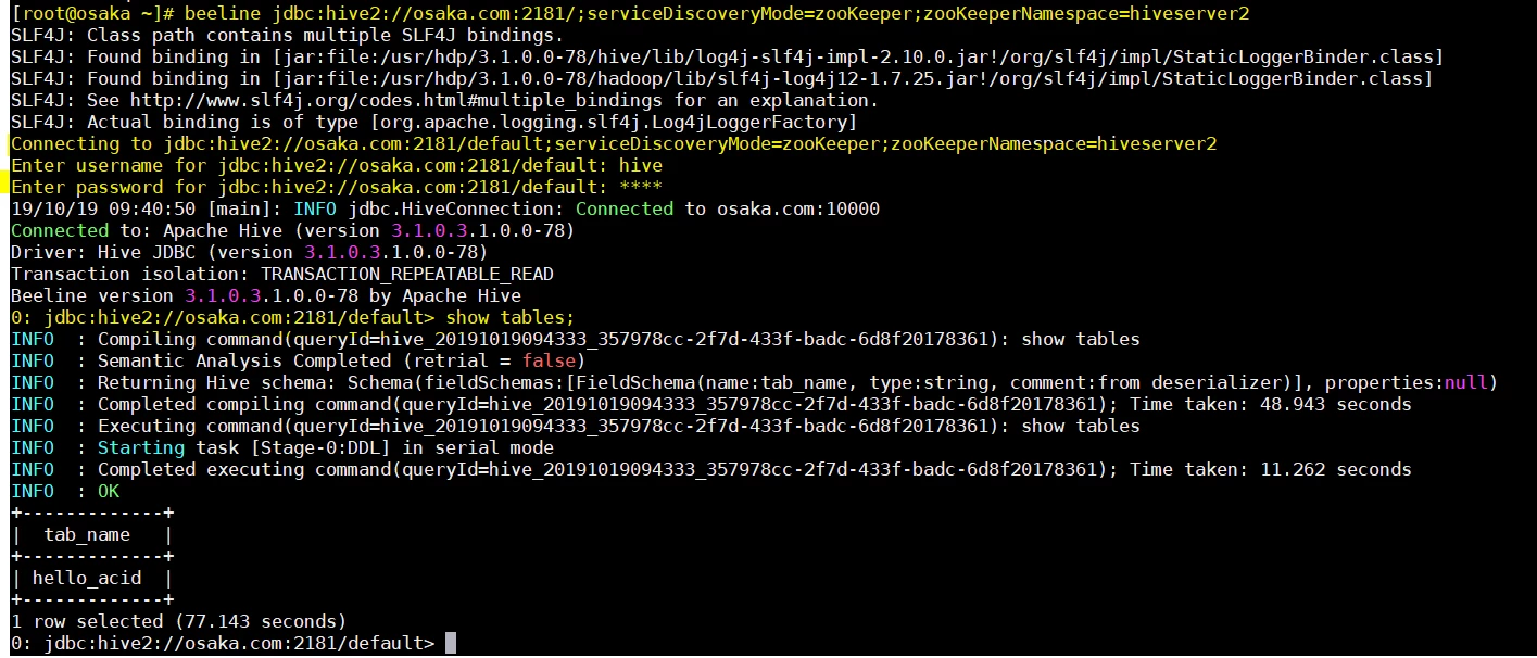

# beeline jdbc:hive2://osaka.com:2181/;serviceDiscoveryMode=zooKeeper;zooKeeperNamespace=hiveserver2
SLF4J: Class path contains multiple SLF4J bindings.
SLF4J: Found binding in [jar:file:/usr/hdp/3.1.0.0-78/hive/lib/log4j-slf4j-impl-2.10.0.jar!/org/slf4j/impl/StaticLoggerBinder.class]
SLF4J: Found binding in [jar:file:/usr/hdp/3.1.0.0-78/hadoop/lib/slf4j-log4j12-1.7.25.jar!/org/slf4j/impl/StaticLoggerBinder.class]
SLF4J: See http://www.slf4j.org/codes.html#multiple_bindings for an explanation.
SLF4J: Actual binding is of type [org.apache.logging.slf4j.Log4jLoggerFactory]
Connecting to jdbc:hive2://osaka.com:2181/default;serviceDiscoveryMode=zooKeeper;zooKeeperNamespace=hiveserver2
Enter username for jdbc:hive2://osaka.com:2181/default: hive
Enter password for jdbc:hive2://osaka.com:2181/default: ****
19/10/19 09:40:50 [main]: INFO jdbc.HiveConnection: Connected to osaka.com:10000
Connected to: Apache Hive (version 3.1.0.3.1.0.0-78)
Driver: Hive JDBC (version 3.1.0.3.1.0.0-78)
Transaction isolation: TRANSACTION_REPEATABLE_READ
Beeline version 3.1.0.3.1.0.0-78 by Apache Hive
0: jdbc:hive2://osaka.com:2181/default> show tables;
INFO : Compiling command(queryId=hive_20191019094333_357978cc-2f7d-433f-badc-6d8f20178361): show tables
INFO : Completed executing command(queryId=hive_20191019094333_357978cc-2f7d-433f-badc-6d8f20178361); Time taken: 11.262 seconds
INFO : OK
| tab_name |
| hello_acid |
1 row selected (77.143 seconds)

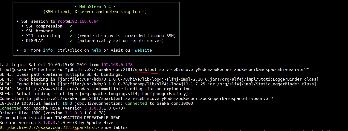

Specifying a database in the connect string
# beeline -u "jdbc:hive2://osaka.com:2181/sparktest;serviceDiscoveryMode=zooKeeper;zooKeeperNamespace=hiveserver2"
Connecting to jdbc:hive2://osaka.com:2181/sparktest;serviceDiscoveryMode=zooKeeper;zooKeeperNamespace=hiveserver2
19/10/19 10:01:21 [main]: INFO jdbc.HiveConnection: Connected to osaka.com:10000
0: jdbc:hive2://osaka.com:2181/sparktest> show tables;

Can you share the output od the below
I see you using port 10001 ???
