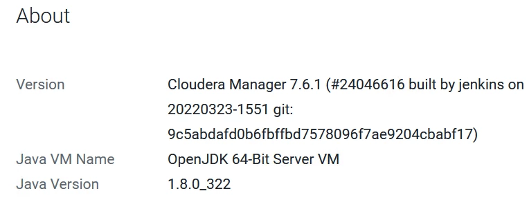

Hi @aakulov,
we are using on-prem(bare-metal clustercloudera-manager.PNG)
Cloudera manager version 7.6.1
Cloudera Runtime 7.1.7 (Parcels)
we configured the AWS credentials the same way as per the links shared by you, but getting unable to load AWS credentials with directory included in s3a Url (ex:"s3a://test/directory")
