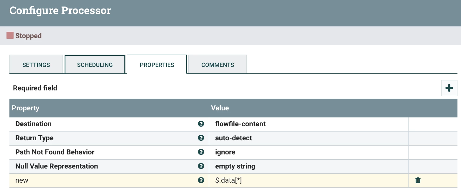

Not sure if this is the best solution, but you could use a combination of EvaluateJsonPath and ReplaceText to convert you sample source in to you sample output.
 EvaluateJsonPath processor:
'new"dynamic property (can use any property name) = $.data[*]
this would result in this output based on your example:
[{"timestamp_start":0,"timestamp_stop":0}]

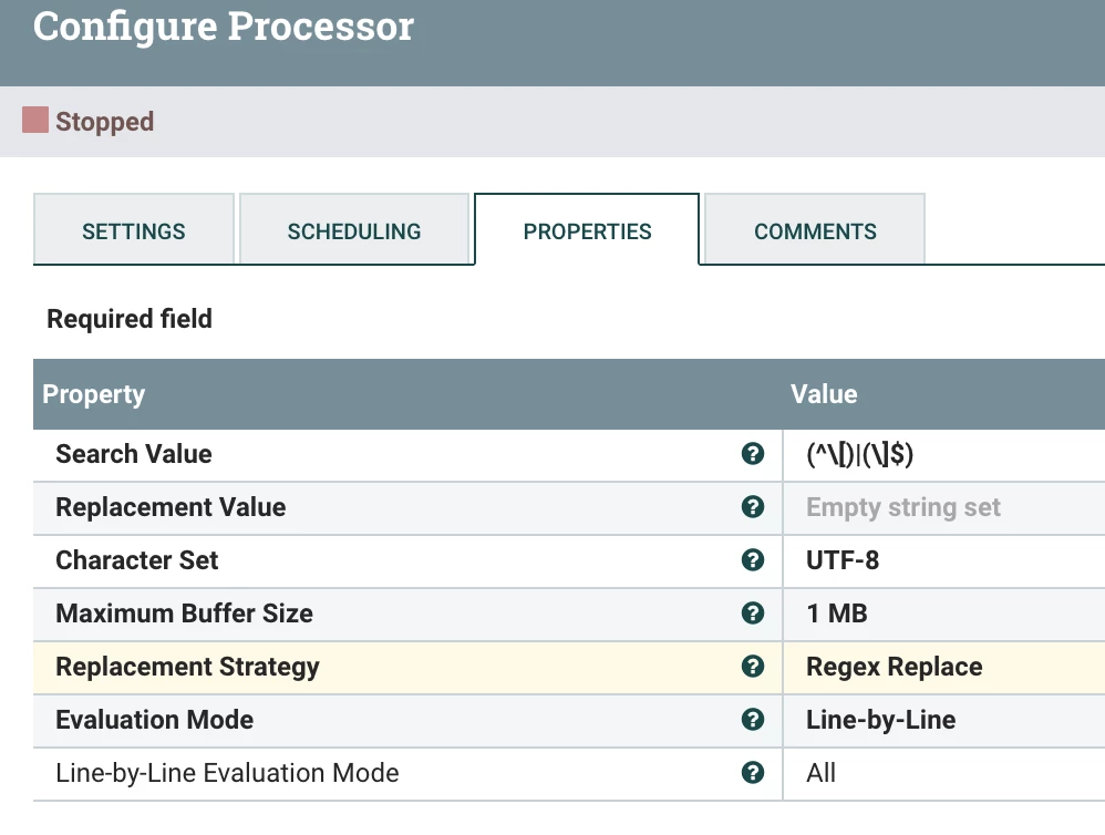

So we can then use the replaceText to trim off the leading "[" and trailing "]":
Search Value = (^\[)|(\]$)
Then you have you desired output of:
