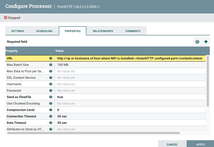

localhost means same host on which the service is running, so you can't use localhost in a postHTTP processor running on MiNiFi (host B) and expect it to sent FlowFiles to ListenHTTP running on another host (host A).
The postHTTP is going to transmit FlowFiles to another host, so why would you configure postHTTP running on your MiNiFi Host with the MiNiFi IP and port?
in the PostHTTP url used is server hostname and port number because MiNiFi is running on this server
Maybe I am just misunderstanding what you are saying in above statement.
It also does not appear that the URL is correct. It appears to be missing the "Base path" (default contentListener) as described in the processors documentation.
To help you out, I build this flow so I can share screenshots of how it is configured for you:
Here is PostHTTP configuration which would be used on MiNiFi (host B):

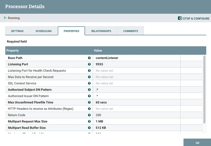

Here is configuration of ListenHTTP used on the NiFi instance (host A) that will receive FlowFiles from above PostHTTP on your MiNiFi (host B):
In my configuration I used port 9933, but you can use any unused non privileged port available on your NiFi instance (host A).

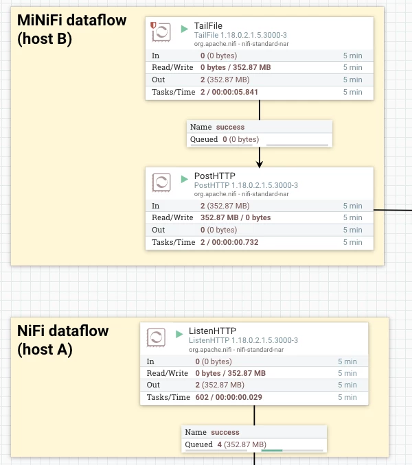

Image 1 of the tailFile processor.  This the processor that is feeding the PostHTTP processor on the MiNiFi  instance installed on (host B), correct?  You configured it to tail a nifi-app.log (which is not configured with the absolute path) which is generated by NiFi (host A).   As I mentioned before, the tailFile processor can not tail a file located on a different host form where the tailFile is executing).
Image 3 showing dataflow. Why is ListenHTTP success relationship connected to PostHTTP?

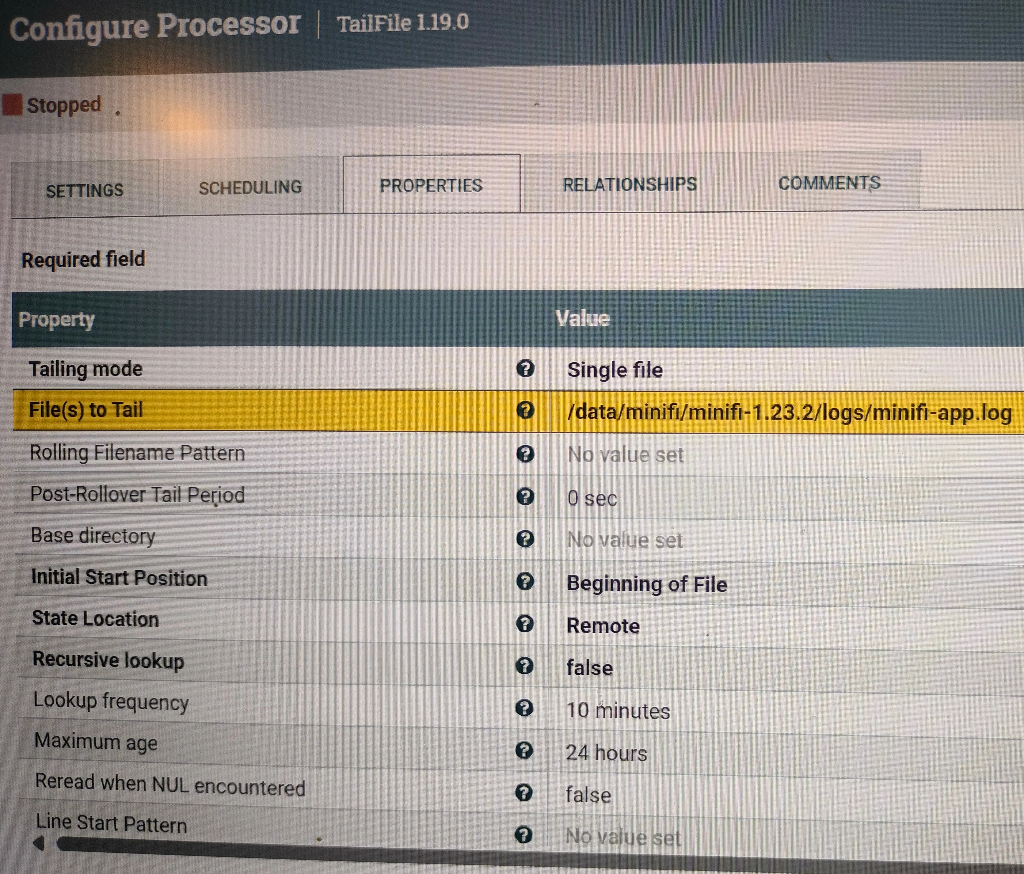

As per the above screenshots I have configured tailfile processor as below

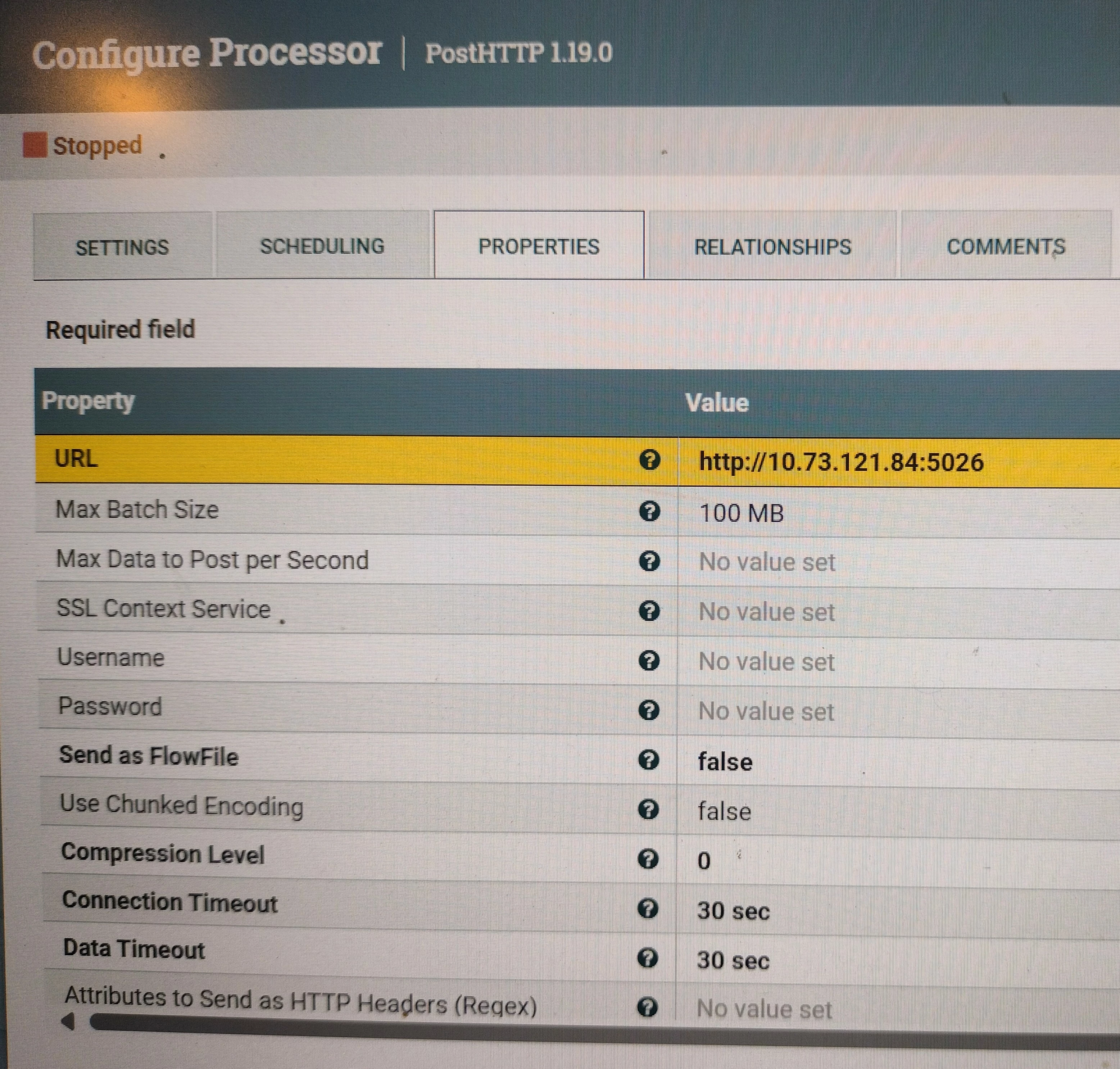

Nextly connected tailfile with PostHTTP and configured as below as provided hostname of nifi and port of nifi url
 Still it is not working.could you please provide any link that I can go with the data flow for success relationship that to read remote file in nifi using minifi.

You are still not using the correct URL in your postHTTP as I stated in last response:
It needs to be based on what you shared in yoru last response:
http://10.73.121.84:5026/contentListner
 The ListenHTTP processor defines the "Base Path" on which it is listening for inbound connections.  The default value is "contentListener".  So the PostHTTP needs to post to that Base Path.
