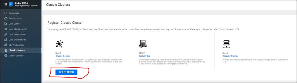

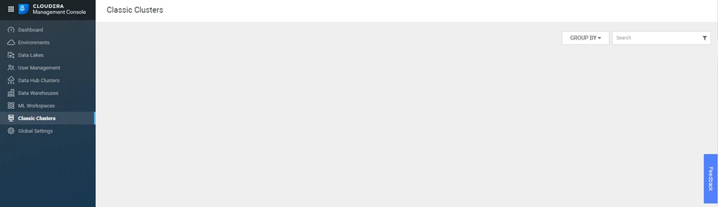

Hi Everyone.

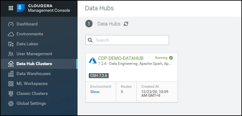

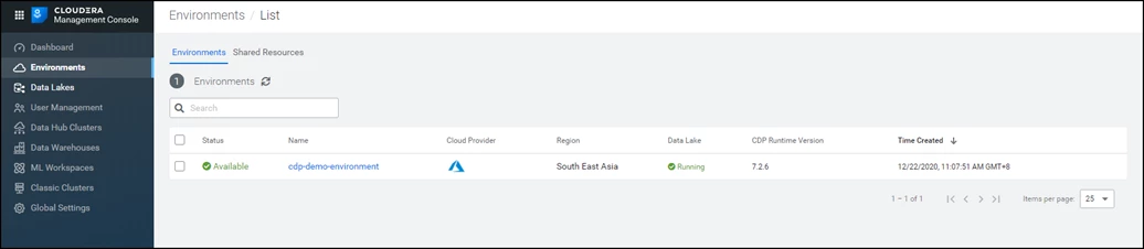

I already have a Data Lake and Data Hub running in my CDP environment but I’m having issues with registering the ‘Classic Clusters’.
After clicking ‘Get Started’ the next screen is basically a blank page? Attached are screenshots for reference. Please help to provide your inputs.classic_cluster1.pngclassic_cluster2.pngData_hub.pngEnvironment.png

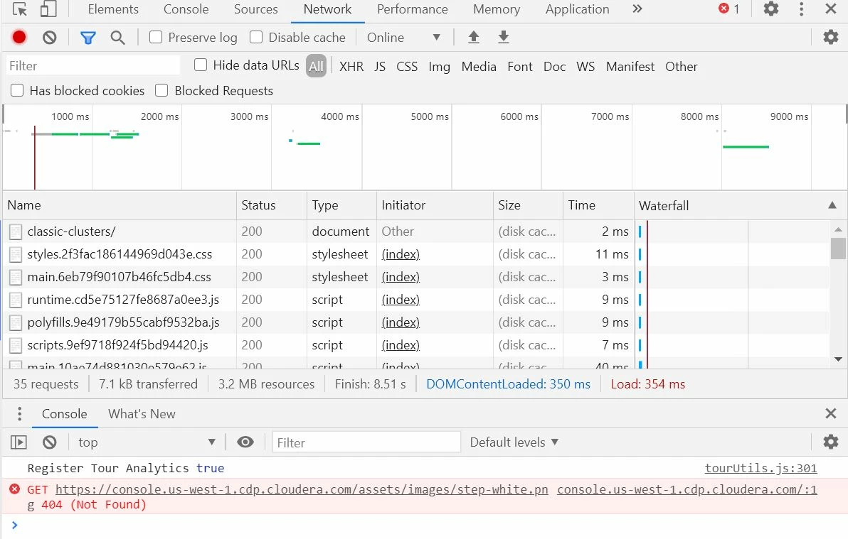

@chhaya_vishwaka Can you check from the Web Developer tool while doing this operation and see if in console there is any issue appearing.

Hi @GangWar  thank you for your reply. I tried Developer tool and I'm getting error as attached, could you suggest a possible fix ? console_error.JPG
