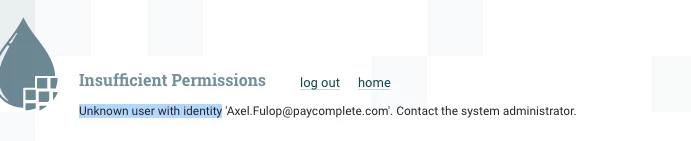

Unknown user with identity OIDC Azure AD
Hello, i'm using the cetic helm chart to deploy nifi to GCP gke cluster. I have configured SSL and OIDC with azure AD, i was able to see the AD page and log in, after that i'm seeing this error
Values:

I followed this tutorial to create the Azure AD app : https://github.com/benkelly/NiFi-Authentication-with-Azure-Active-Directory-Setup-Guide
Any idea of what i'm missing?

@axelfulop
NiFi Authorization is case sensitive.  In your authorizers.xml (responsible for generating the users.xml and authorizationsxml files if and only if they do NOT already exist) you have defined your "initial user identity 1" and "Iniital admin identity" as:
axel.fulop@paycomplete.com
However, your attached screenshot of the the NiFi UI, shows the authenticated user's 'user identity" was:
Axel.Fulop@paycomplete.com
 NiFi's authorizer will treat these two identities as different user identities since it is case sensitive.
There are two ways to resolve this:
1. Update Authorizers.xml entries to use "Axel.Fulop@paycomplete.com", remove users.xml, remove authorizations.xml and then restart NiFi.  These two files will get recreated based on new user identity.
2. Add a set of identity mapping properties to the nifi.properties file that will take all authenticated user identities and set them to all lowercase:
nifi.security.identity.mapping.pattern.username=^(.*?)$
nifi.security.identity.mapping.value.username=$1
nifi.security.identity.mapping.transform.username=LOWER
This would result in the identity string resulting from successful authentication is converted to all lowercase before being passed to the configured NiFi authorizer.

Hello Matt, it was that! omg, 2 weeks stucked  with this and was just case sensitive!
Thanks!
