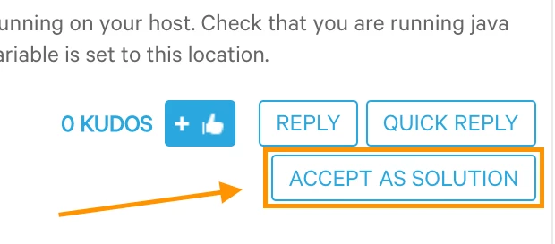

cjervis
Community Manager
Community Manager
May 10, 2019 8:52 PM UTC
@Tipo33 Thanks for letting us know you solved your issue. If you could mark the reply as the solution it would help others in a similar situation find it in the future.
