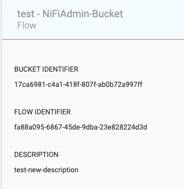

The rest of what you need to make this rest-api call can be obtained via the NiFi-registry's UI for the flow to be modified:
Using above example:
<versioned flow name> = "test"
<bucket uuid> = "17ca6981-c4a1-418f-807f-ab0b72a997ff"
<versioned flow UUID> = "fa88a095-6867-45de-9dba-23e828224d3d"
