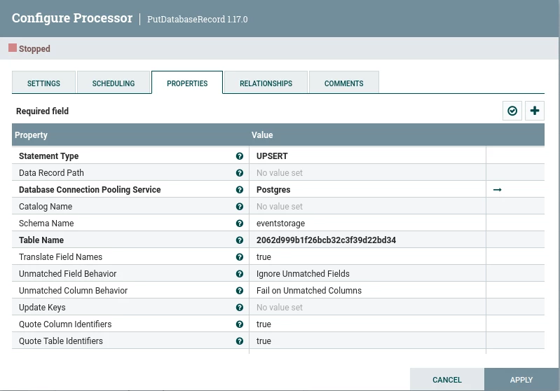

Hi,
I'm using a PutDatabaseRecord with UPSERT statement for a PostgreSQL database, but the ON CONFLICT keys are not being quoted event with the setting "Quote Column Identifiers" set to true.
ERROR:
Batch entry 0 INSERT INTO "eventstorage"."2062d999b1f26bcb32c3f39d22bd34"(..., "FDZ_UUID", ...) VALUES (...) ON CONFLICT (FDZUUID) DO UPDATE SET (...) = (..., EXCLUDED."FDZ_UUID", ...) was aborted: ERROR: column "fdzuuid" does not exist
I've seen an JIRA issue regarding this behavior and it is as Resolved: https://issues.apache.org/jira/browse/NIFI-8043.
I'm using nifi 1.17.0
@MattWhosorry for pinging you directly, but you were the assignee of the jira ticket and I've seen you commenting other similar posts.
Thanks

Update: Created a custom processor by duplicating PutDatabaseRecord and added the if statement that was done in the commit https://github.com/apache/nifi/pull/4772/commits/0d6bca493842286ddae6a0577dfed55cd1808f7c. It solved the issue but I had to create a NAR with all of the bundled dependencies in nifi-standard-processors because I was having an error while starting NiFi (https://community.cloudera.com/t5/Support-Questions/Nifi-throwing-error-on-startup/m-p/240893)
I've checked the code base and the if statement is not present in Nifi > 1.12
Hey @MattWho, since you were the only one helping and @mburgess is not replying to the ticket, do you think it is possible/doable to create an hot-fix or something like that to have this commit? - I've seen more people complaining regarding this issue and it would be useful to not duplicate the source code just to add an if statement
Thanks

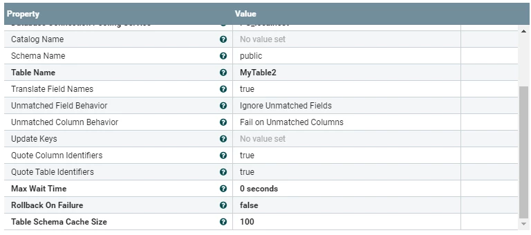

I created two tables with camelcase in table and colum names: MyTable and MyTable2 with similar columns list using queries:
Spoiler
CREATE TABLE IF NOT EXISTS
public."MyTable" ("Id" SERIAL PRIMARY KEY, "Col1" VARCHAR(1024), "createdAt" TIMESTAMP DEFAULT NOW());
public."MyTable2" ("Id" SERIAL PRIMARY KEY, "Col1" VARCHAR(1024), "createdAt" TIMESTAMP DEFAULT NOW());

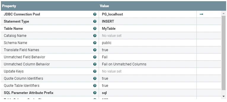

First, I've generated JSON and tried to put some rows in table MyTable using ConvertJSONToSQL. Here is my ConvertJSONToSQL processor:
And here I got a "new" bug. ConvertJSONToSQL quotes schema name along with table name. As result I get "public.MyTable" in constructed query, and Postgres rejects it.
Spoiler
INSERT INTO "public.MyTable" ("Col1") VALUES (?)

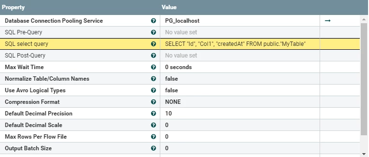

Okay, I've inserted some rows manually in MyTable and tried to clone data using ExecuteSQL processor connected directly to PutDatabaseRecord.
ExecuteSql processor:

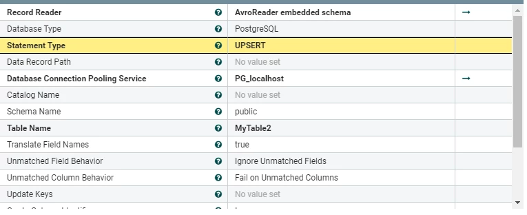

PutDatabaseRecord processor:
PutDatabaseRecord generates correct quoting on "public"."Mytable" but does not quote key column indentifier in ON CONFLINCT clause as topic starter pointed.
Spoiler
INSERT INTO "public"."MyTable2"("Id", "Col1", "createdAt")
VALUES (1, 'value1', '2023-05-16 08:10:56+03')
ON CONFLICT (ID)
DO UPDATE SET ("Id", "Col1", "createdAt") =
(EXCLUDED."Id", EXCLUDED."Col1", EXCLUDED."createdAt")
I hope this helps to figure out how to reproduce this bug.
UPD: PutDatabaseRecord also changes key colum name to uppercase.
