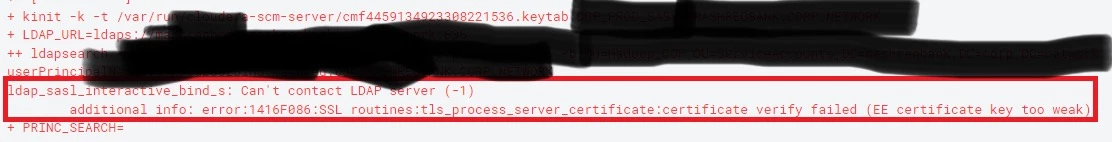

At the step of Generating credentials it fails with attached screenshot.
However, in the same window I noticed that CM is trying to connect to AD on LDAP protocol on port 389. Ideally it should be connecting via LDAPS on 636 as we have TLS also configured and enabled. Not sure if this is even relevant.
From where does CM gets the LDAP URL? I tried to understand gen_credentials_ad.sh script at /opt/cloudera/cm/bin, however, did not completely interpret.

Thank you for the response @tj2007. We have ensured that the required permissions are assigned to the account that is provided to Cloudera to create principals.
we further tweaked some settings and also after a quick modification to gen_credentials_ad.sh script (post discussion with Cloudera support) got through with error. However, now getting below error:
We have scheduled a call later today with Cloudera once again to discuss this. However, if you may be able to suggest something would be helpful.
