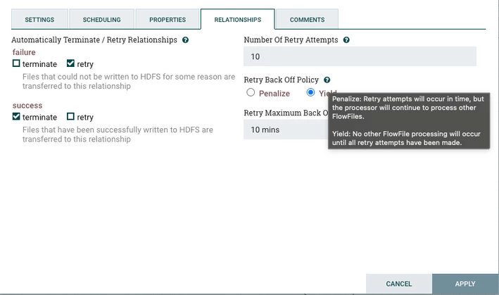

Example:
When you select retry on a relationship like "failure" or "retry" (never select retry on success), you are given the option to specify a retry attempts, a back off policy, and max back off period.
Rather then a FlowFile being routed to the "failure" relationship when "retry" is selected, the FlowFile remains on the incoming queue to be tried again (in above example, 10 attempts will be made before the FlowFile is finally routed to the "retry" relationship.).
The Retry Back Off Policy controls how you want to handle these retries:
 - "Penalize" applies a penalty to the FlowFile on the inbound connection.  NiFi ignores penalized FlowFiles and continues to execute on other non penalized FlowFiles until the penalty expires.
- "Yield"  triggers the processor to yield for a duration of time and then retry the current FlowFile.  This method ensure order of processing as no other FlowFile will be processed until this one is either successfully retried or all retry attempts  have been exhausted and FlowFile has finally been routed to the "failure" relationship.
The Retry Max Back Off Period controls the maximum time the FlowFile will either be penalized or max time processor will yield between retry attempts.  Penalty and yield initial time is controlled by the "Yield Duration" and "Penalty Duration" configured in the processor's "Settings" tab. The duration is repeatedly doubled with each retry until the max backoff period is reached.
