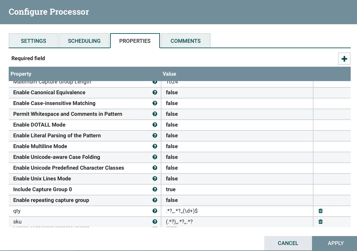

For #1 there are a few ways.  First, you can create a flow that uses a CSV Reader and a known schema.  Using this you can translate and parse the columns. This requires multiple processors and CSVReader Controller Service.    Two, you can just use ExtractText with regex (one processor).
here is example of ExtractText to get a Quantity and SKU from an inventory CSV.  Notice the regex codes used with the commas, and the () indicating which field maps to the attribute defined (sku or qty).
qty:
.*?,,.*?,,(\d+)$
sku:
If your CSV is 10 columns, and #5 is your value, you probably want something like this:

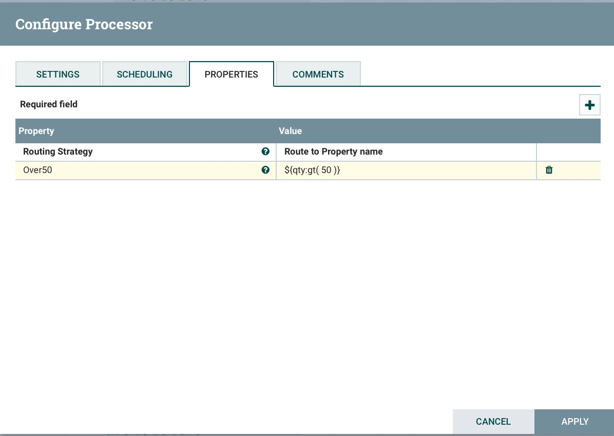

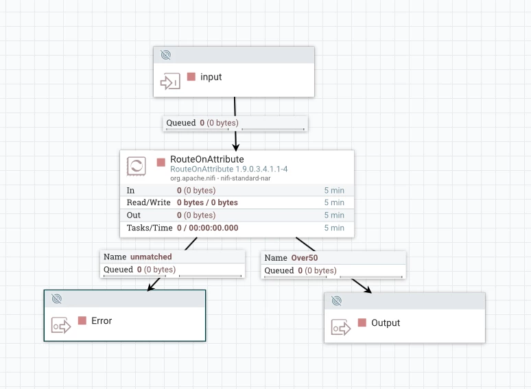

For #2 you want to use RouteOnAttribute Processor with routes defined using NiFi Expression Language.  You define a route, then when defined you can chose it for downstream of RouteOnAttribute.  Anything else will go to unmatched.
Here is an example:
And Routed:

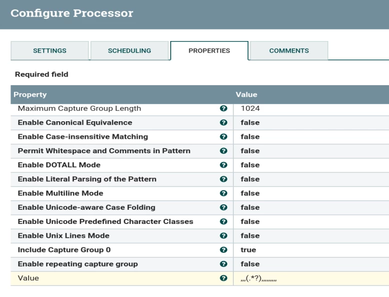

I tried it but got stuck in the ExtractText processor.
My real file consists of 13 columns and #4 is the relevant one with the needed value. The input Flow File that feeds the ExtractText processor looks like this:
#4 is value 25.0 (before "cpm")
Meanwhile i removed the headers since i was not sure if that has got an impact or not.
So what i did next in ExtractText processor is creating a new property named Value:
But when i run the workflow all the flow files goes unmatched off the ExtractText processor. So there are no matched ones that go to RouteOnAttribute.
I really don't know what went wrong here.

Not working in your Use Case, I tried to show as much of mine as I could,  I think you understand the concept.  So the next trick is just getting the REGEX matched to your string.
Try a tool here: https://regex101.com
In this tool I quickly matched REGEX to 4th column:
to:
test,test,test,25.0,test,test,test
For your example, the above should work.   It is not necessary to parse past the column you need, so the .* on end should pickup entire rest of the line.
