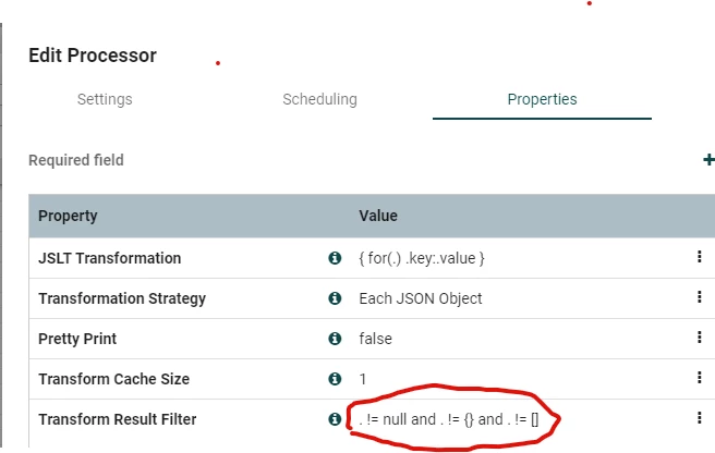

 3- JSLT: I like to introduce people to JSTL which is another transformation language supported by Nifi if you are using version 1.16 and above using JSLTTransformJson. Jstl can simplify transformation in some scenarios over jolt. For example in this case the transformation will be as simple as this:
{for(.) .key:.value}
The default filtering applied will take care of this:
If you find this helpful please accept solution.
