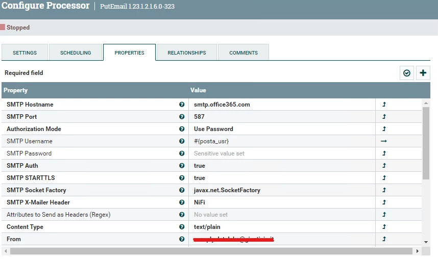

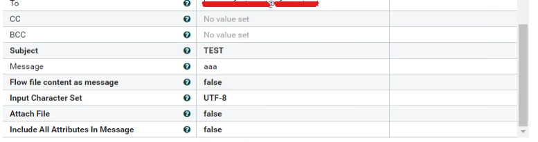

I am trying to integrate sending emails from NiFi using the put email processor. Below is my configuration:
When I start the processor I get this error:
Failed to properly initialize Processor. If still scheduled to run, NiFi will attempt to initialize and run the Processor again after the 'Administrative Yield Duration' has elapsed. Failure is due to java.lang.NullPointerException: java.lang.NullPointerException
Do you have any advice regarding the configuration?

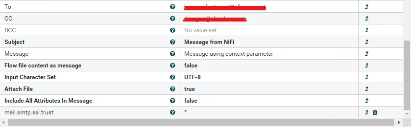

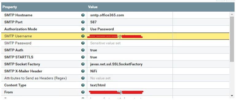

Hi all,
I solved sending emails using this configuration:
Lorenzo

Hi all,
Lorenzo
