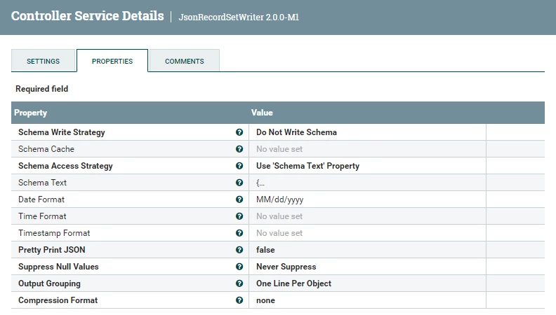

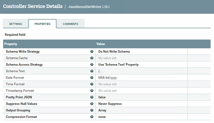

In the validaterecord Record Writer Im using JsonRecordSetWriter with the following configuration:

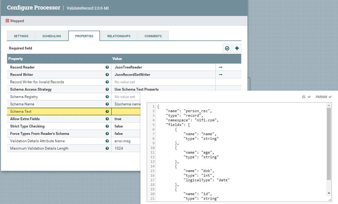

Where I'm using the following avro schema in the Schema Text property:
"name": "person_rec",
"type": "record",
"namespace": "nifi.com",
"fields": [
"name": "name",
"type": "string"
"name": "age",
"type": "int"
"name": "dob",
"type": "int",
"logicalType": "date"
"name": "id",
"type": "string"
Also I'm setting the Date Format to : MM/dd/yyyy

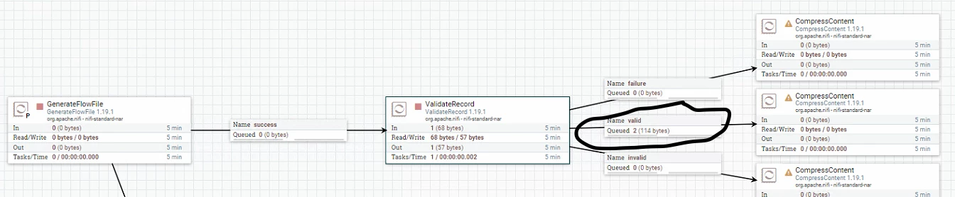

@SAMSAL I just tried what you have describe using an GenerateFlowFile (where I set your JSON text) and a ValidateRecord and I can't really reproduce your error. (NiFi 1.19.1)

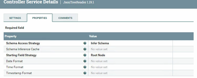

I used an JSON Reader, with default settings - Infer Schema and no Date Format set.
Next, in terms of writer, as you stated, I used an JsonRecordSetWriter, where I defined your mentioned schema and tried with and without the date format.
Each time, my FlowFile when into the valid queue, without any errors.

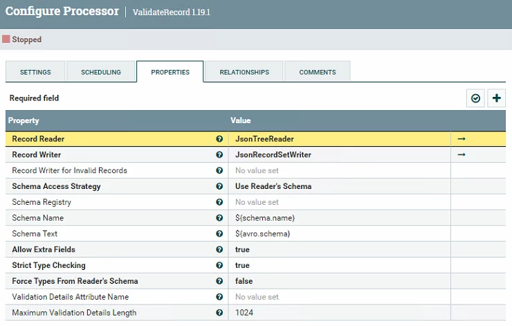

In terms of properties, the following have been configured in my ValidateRecord Processor:

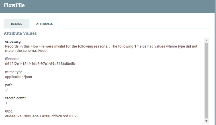

Thanks for your help. Actually you are right. Im not sure what I was thinking when I posted this or under what circumstances I was getting this error but I retried what I posted and it work so I apologize if I wasted your and the community time. However, what if I want to store the schema in the ValidateRecord processor itself as I would think that would be the proper way to use. Notice how in that processor there is no such field for setting the Date\Time format , and if I provide my schema to it by setting (Use Schema Text Property) I dont get an error but my flowfile goes to the "invalid" relationship complaining that the dob filed doesnt have the valid type!
In this case I did not use any schema def in the record reader\write but I kept the data format set to MM/dd/yyyy.
Is there a way to fix this or am I using the processor the wrong way?
