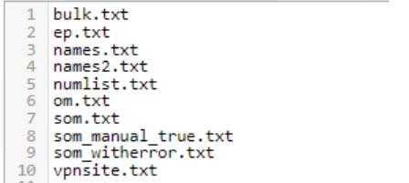

I have a flowfile that is a list of files,
that gets split into individual flowfiles (10 in this case)
I am using FetchSFTP to fetch the file from a sftp location, the content of this fetched file is then split and is processed and stored.
In this example: I want to start processing ep.txt only after i have processed bulk.txt after that names.txt and so on.

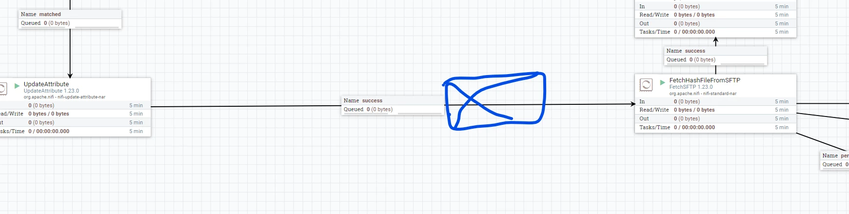

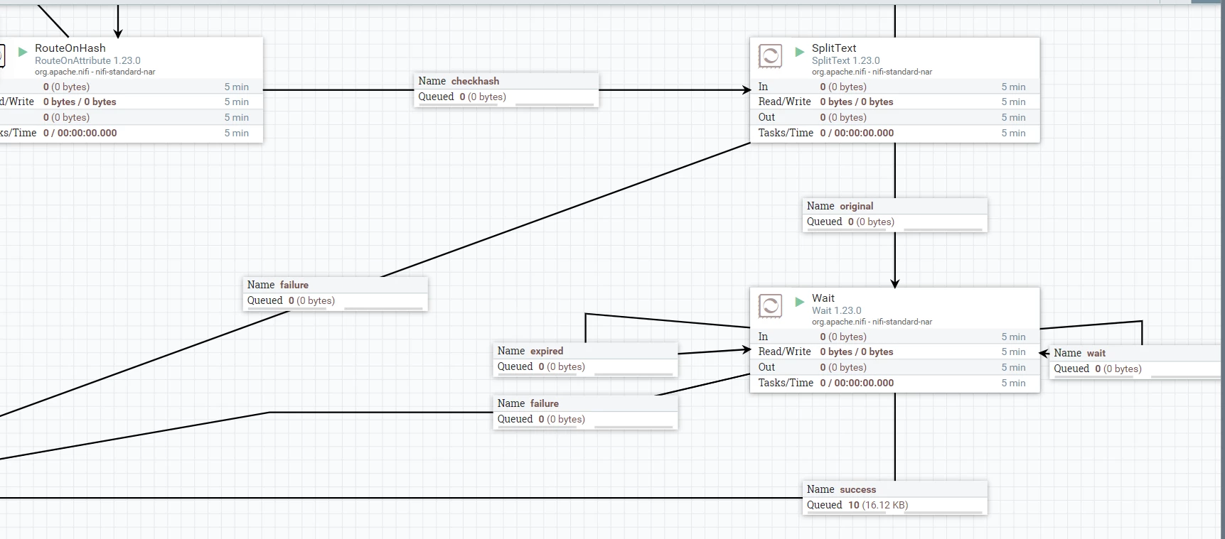

I was able to implement something like this.
but this is not what I was looking for, I want to implement a wait before fetchSFTP
I tried release signal identifier with filename , but that was stopping any flowfile from moving forward.

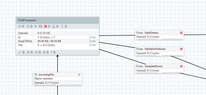

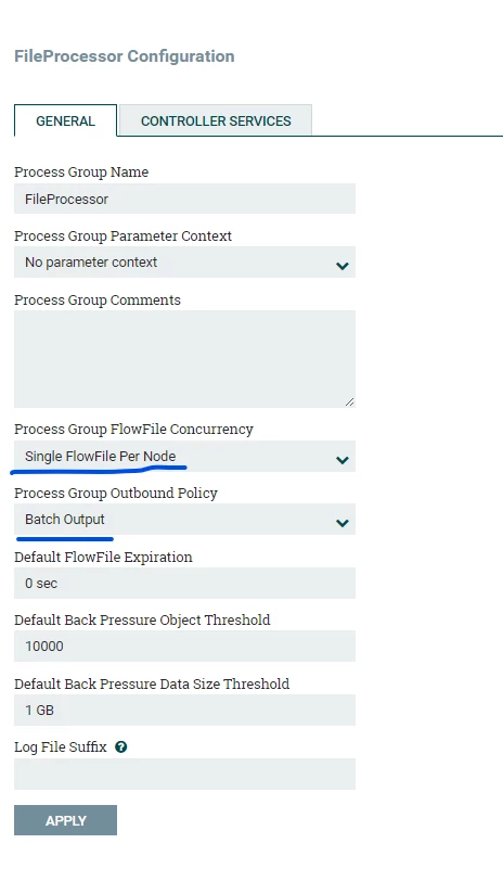

Update :
This is working as I hoped for
With this configuration the FileProcessor group will take the next flowfile  only  after completely processing the flowfile that is inside the group.
Thank you @SAMSAL, @pvillard
