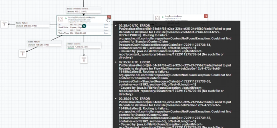

Hi @MattWho
We are streaming data continuosly to our NIFI PutDataBaseRecord Processor.
When any Nifi restart or crash happens , the streaming data during that time get failed with below exception.

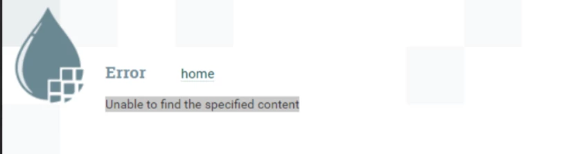

we can able to see the failed queues but once we select View to see the data it says below
Please kindly help me on this.

@CDC-
I encourage you to start a new community question rather then adding to an existing question with an accepted answer.   Your query is really unrelated to this question.  Something appears to be happening to your content prior to even reaching the PutDataBaseRecord processor.  I say this because the exception shared indicates the processor is looking for the content in an "archived" content claim.  Content claims are only moved to archive once the claimant count is zero (meaning no actively queued FlowFiles are still referencing content on that claim).  Any content claims moved to archive are subject to removal/deletion by the background archive clean-up thread.  So not surprised the content is missing.  The real question here is what is the lineage of this FlowFile and at what point upstream from your putDatabaseRecord  processor did the problem develop.
Please start a new community question and provide as much detail as possible.
