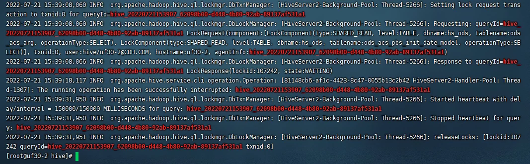

some more information to add:
it seems that in DbTxnManager, failed or terminated sql queries will not leave stale locks behind, as there are heartbeat mechanisms involved. Only when the hs2 process is not functioning properly, like when the hs2 host crashed, will there be staled locks left behind, and we have to manually clear them by logging into the metastore db.
