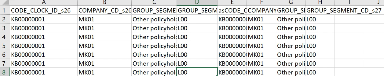

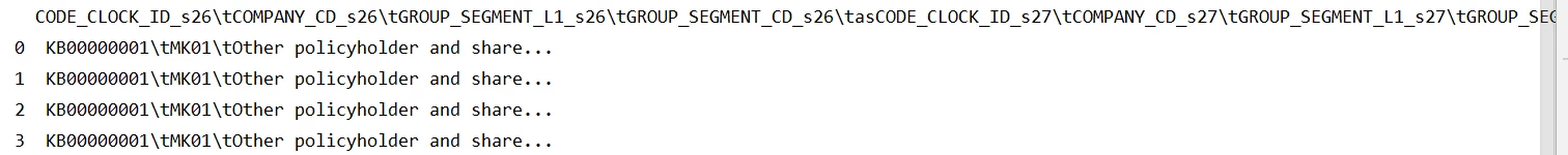

I have scenario where I am getting the file(stream:flowfile of NIFI) as of type csv file, then creating the dataframe and dumping it thats it. But after creating the dataframe the structure of the file got disturbed, if I open the same flowfile on my disk i could see clear structure with columns separated with tab, but with python dataframe I am not getting the same structure, if I get same structure i can perform row manipulation.

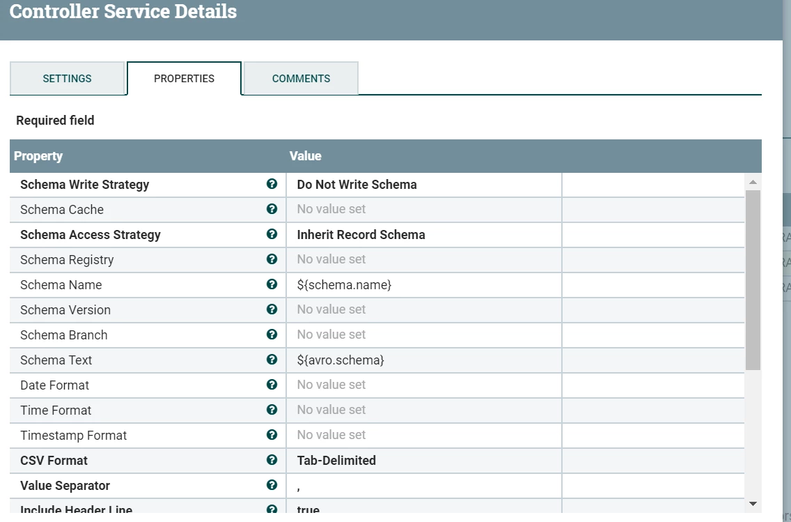

2: then passing this record to ConvertRecord processor to convert this avro record type csv file separated by tab.
convertRecordSetWriter settings...

3: Then the reading flowfile(step 2 folowfile) as python data using ExecuteStreamCommand, coz I am want to perform some action on the database record, to do this my record structure has been changed in data frame.

it did work after adding '\t' to read_csv as 2nd arg.
