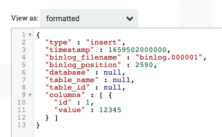

I was also able to configure the CaptureChangeMySQL processor to capture changes without any other privileges being granted:
