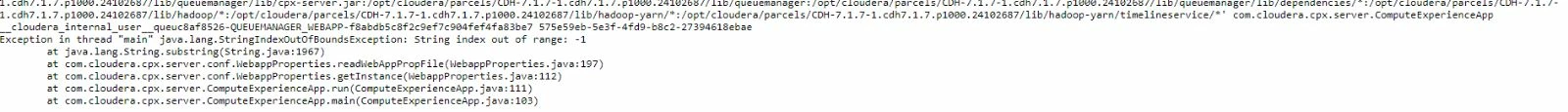

We have added certificates in java trust store (cacerts) for all the servers. Yarn QM UI does open, but not in tls mode. We have enabled auto tls, and the yarn queue manager / UI does not open with tls enabled for it. Attached are the error and role log snips
Role Log
Stderror
Thanks

@Amn_468
Thank you for sharing the logs.
We can see that you are getting the following error.
Exception in thread "main" java.lang.StringIndexOutOfBoundsException: String index out of range: -1
As per the above exception we have checked the code of WebappProperties and it's failing while parsing the configs with this code:
 } else if (val.contains("#")) {
  val = val.substring(0, val.indexOf(" "));
There is # in your SSL password hence it's failing. We have replicated this issue in the test lab and the queue manager was failing to start with the same error.
You should change the password of keystore and truststore and make sure that it will not have # in it or remove SSL settings temporarily.
