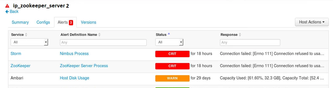

YARN - Zookeeper failing a few moments after restart
Good morning guys, thanks in advance for your help!
I have a project that fails. I'm trying to restart all the services manually but havent been able to.
I have a few questions and I'd really appreciate if you can give me some guidance because at this moment I'm kinda stuck.
1. How do I check what services need to be "up and running" before restarting the next one? Is there any place where I can see the dependency?
2. Do I need 2 ZooKeeper servers up and running? The first one is running in localhost but the 2nd one runs in a different machine. If I actually need them both, how can I check what was wrong in the second one?

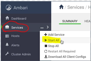

@Ray Teruya
Start-all-services-from-Ambari
Start all services. Use Ambari UI > Services > Start All to start all services at once. In Ambari UI > Services you can start, stop, and restart all listed services simultaneously. In Services, click ... and then click Start All.
The first place to check for start failures or success in /var/logs/zookeeper/zookeeper.log or zookeeper-zookeeper-server-[hostname].out
According to HWX documentation make sure to manually start the Hadoop services in this prescribed order
The above gives you the list and order of dependency
If you are not run an HA configuration a single zookeeper suffice, but if you want to emulate a production environment with many data nodes to enable [HA Namenode or RM] you MUST have at least 3 zookeepers to avoid the split-brain phenomenon
Hope that helps

ray_teruya
Silver ⭐️⭐️
Aug 1, 2019 2:21 AM UTC
Thanks @Geoffrey Shelton Okot for your help!
I did restart all services manually but seems that ZK still fails. From the screenshot I posted, one of my ZK servers is always down. Since ZK needs to be up and running before anything else, I'd like to fix this issue before anything else. I checked the error message from Ambari and it says
The error message says
Connection failed: [Errno 111] Connection refused to ip_zookeeper_server2:2181
What else can I do to fix this?
update:
This is what the log file shows on that machine
2019-07-31 07:57:58,187 - INFO [main:QuorumPeerConfig@103] - Reading configuration from: /usr/hdp/current/zookeeper-server/conf/zoo.cfg
2019-07-31 07:57:58,191 - WARN [main:QuorumPeerConfig@291] - No server failure will be tolerated. You need at least 3 servers.
2019-07-31 07:57:58,191 - INFO [main:QuorumPeerConfig@338] - Defaulting to majority quorums
2019-07-31 07:57:58,196 - INFO [main:DatadirCleanupManager@78] - autopurge.snapRetainCount set to 30
2019-07-31 07:57:58,197 - INFO [main:DatadirCleanupManager@79] - autopurge.purgeInterval set to 24
2019-07-31 07:57:58,198 - INFO [PurgeTask:DatadirCleanupManager$PurgeTask@138] - Purge task started.
2019-07-31 07:57:58,210 - INFO [main:QuorumPeerMain@127] - Starting quorum peer
2019-07-31 07:57:58,219 - INFO [PurgeTask:DatadirCleanupManager$PurgeTask@144] - Purge task completed.
2019-07-31 07:57:58,223 - INFO [main:NIOServerCnxnFactory@94] - binding to port 0.0.0.0/0.0.0.0:2181
2019-07-31 07:57:58,233 - INFO [main:QuorumPeer@992] - tickTime set to 2000
2019-07-31 07:57:58,233 - INFO [main:QuorumPeer@1012] - minSessionTimeout set to -1
2019-07-31 07:57:58,233 - INFO [main:QuorumPeer@1023] - maxSessionTimeout set to -1
2019-07-31 07:57:58,233 - INFO [main:QuorumPeer@1038] - initLimit set to 10
2019-07-31 07:57:58,245 - INFO [main:FileSnap@83] - Reading snapshot /hadoop/zookeeper/version-2/snapshot.8600bc40ab
2019-07-31 07:58:41,800 - ERROR [main:NIOServerCnxnFactory$1@44] - Thread Thread[main,5,main] died
java.lang.OutOfMemoryError: GC overhead limit exceeded
at org.apache.jute.BinaryInputArchive.readBuffer(BinaryInputArchive.java:97)
at org.apache.zookeeper.server.DataNode.deserialize(DataNode.java:158)
at org.apache.jute.BinaryInputArchive.readRecord(BinaryInputArchive.java:103)
at org.apache.zookeeper.server.DataTree.deserialize(DataTree.java:1194)
at org.apache.zookeeper.server.util.SerializeUtils.deserializeSnapshot(SerializeUtils.java:127)
at org.apache.zookeeper.server.persistence.FileSnap.deserialize(FileSnap.java:127)
at org.apache.zookeeper.server.persistence.FileSnap.deserialize(FileSnap.java:87)
at org.apache.zookeeper.server.persistence.FileTxnSnapLog.restore(FileTxnSnapLog.java:130)
at org.apache.zookeeper.server.ZKDatabase.loadDataBase(ZKDatabase.java:223)
at org.apache.zookeeper.server.quorum.QuorumPeer.loadDataBase(QuorumPeer.java:483)
at org.apache.zookeeper.server.quorum.QuorumPeer.start(QuorumPeer.java:473)
at org.apache.zookeeper.server.quorum.QuorumPeerMain.runFromConfig(QuorumPeerMain.java:153)
at org.apache.zookeeper.server.quorum.QuorumPeerMain.initializeAndRun(QuorumPeerMain.java:111)
at org.apache.zookeeper.server.quorum.QuorumPeerMain.main(QuorumPeerMain.java:78)
