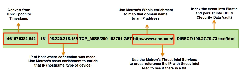

  1. The proxy events from Squid logs need to be ingested in real-time.
  2. The proxy logs must be parsed into a standardized JSON structure that Metron can understand.
  3. In real-time, the squid proxy event must be enriched so that the domain names are enriched with the IP information.
  4. In real-time, the IP within the proxy event must be checked for threat intel feeds.
  5. If there is a threat intel hit, an alert needs to be raised.
  6. The end user must be able to see the new telemetry events and the alerts from the new data source.
  7. All of these requirements will need to be implemented easily without writing any new Java code.

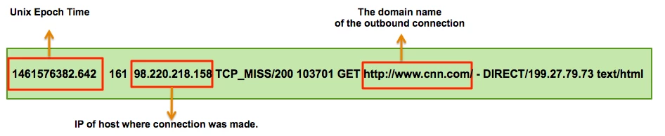

    1461576382.642 161 127.0.0.1 TCP_MISS/200 103701 GET http://www.hostsite.com/ - DIRECT/199.27.79.73 text/html
    1461576442.228 159 127.0.0.1 TCP_MISS/200 137183 GET http://www.hostsite.com/ - DIRECT/66.210.41.9 text/html
  4. Using the Squid log entries, we can determine the format of the log entires which is:
    timestamp | time elapsed | remotehost | code/status | bytes | method | URL rfc931 peerstatus/peerhost | type

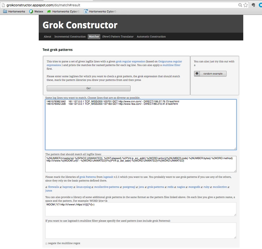

  2. Next we need to define the Grok expression for our log. Refer to Grok documentation for additional details. In our case the pattern is:
    WDOM [^(?:http:\/\/|www\.|https:\/\/)]([^\/]+) SQUID_DELIMITED %{NUMBER:timestamp} %{SPACE:UNWANTED} %{INT:elapsed} %{IPV4:ip_src_addr} %{WORD:action}/%{NUMBER:code} %{NUMBER:bytes} %{WORD:method} http:\/\/\www.%{WDOM:url}\/ - %{WORD:UNWANTED}\/%{IPV4:ip_dst_addr} %{WORD:UNWANTED}\/%{WORD:UNWANTED}
    Notice the WDOM pattern (that is more tailored to Squid instead of using the generic Grok URL pattern) before defining the Squid log pattern. This is optional and is done for ease of use. Also, notice that we apply the UNWANTED tag for any part of the message that we don't want included in our resulting JSON structure. Finally, notice that we applied the naming convention to the IPV4 field by referencing the following list of field conventions.
  3. The last thing we need to do is to validate the Grok pattern to make sure it's valid. For our test we will be using a free Grok validator called Grok Constructor. A validated Grok expression should look like this:

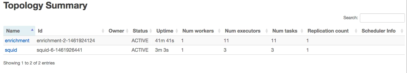

Step 6: Deploy the new Parser Topology
Now that we have the Squid parser topology defined, lets deploy it to our cluster.
  1. Deploy the new squid paser topology:
    sudo storm jar /usr/metron/0.1BETA/lib/metron-parsers-0.1BETA.jar org.apache.storm.flux.Flux --filter /usr/metron/0.1BETA/config/elasticsearch.properties --remote /usr/metron/0.1BETA/flux/squid/remote.yaml
  2. If you currently have four topologies in Storm, you need to kill one to make a worker available for Squid. To do this, from the Storm UI, click the name of the topology you want to kill in the Topology Summary section, then click Kill under Topology Actions. Storm will kill the topology and make a worker available for Squid.
  3. Go to the Storm UI and you should now see new "squid" topology and ensure that the topology has no errors3817-squid-parser-topology.png
This squid processor topology will ingest from the squid Kafka topic we created earlier and then parse the event with Metron's Grok framework using the grok pattern we defined earlier. The result of the parsing is a standard JSON Metron structure that then gets put on the "enrichment" Kafka topic for further processing.

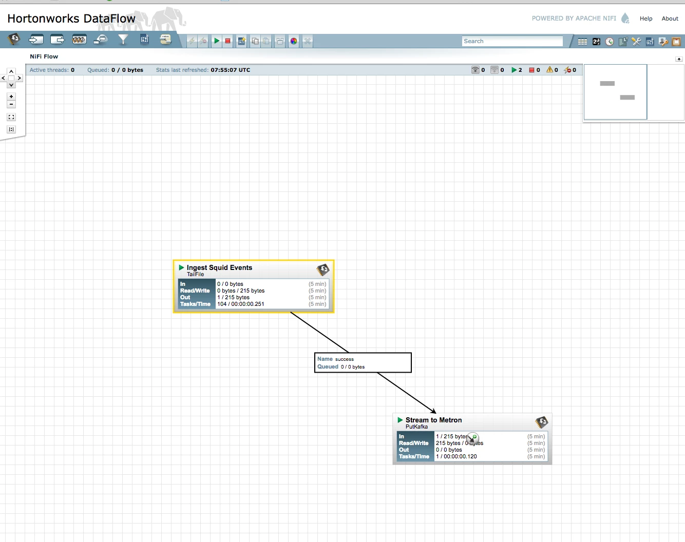

Create a Nifi Flow to stream events to Metron
Now we will create a flow to capture events from squid and push them into metron

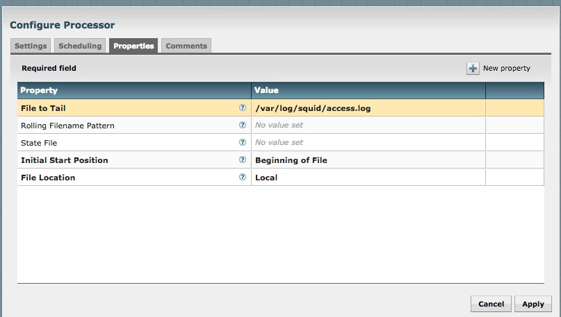

  1. Drag a processor to the canvas (do this by the dragging the processor icon..first icon)
  2. Search for TailFile processor and select Add. Right click on the processor and configure. In settings tab change the name to "Ingest Squid Events"
    1. In properties, configure the following like the following:
  3. Drag Another Processor the canvas
  4. Search for PutKafka and select Add
  5. Right click on the processor and configure. In Settings, change names to "Stream to Metron” click the checkbox for failure and success for relationship.
  6. Under properties, set 3 properties
    1. Known Brokers: node1:6667
    2. Topic Name: squid
    3. Client Name: nifi-squid
  7. Create a connection by dragging the arrow from Ingest Squid Events to Stream to Metron
  8. Select the entire Flow and click the play button (play button). you should see all processors green like the below:
  9. Generate some data using squidclient (do this for about 20+ sites)
    squidclient http://www.hostsite.com
  10. You should see metrics on the processor of data being pushed into Metron.
  11. Look at the Storm UI for the parser topology and you should see tuples coming in

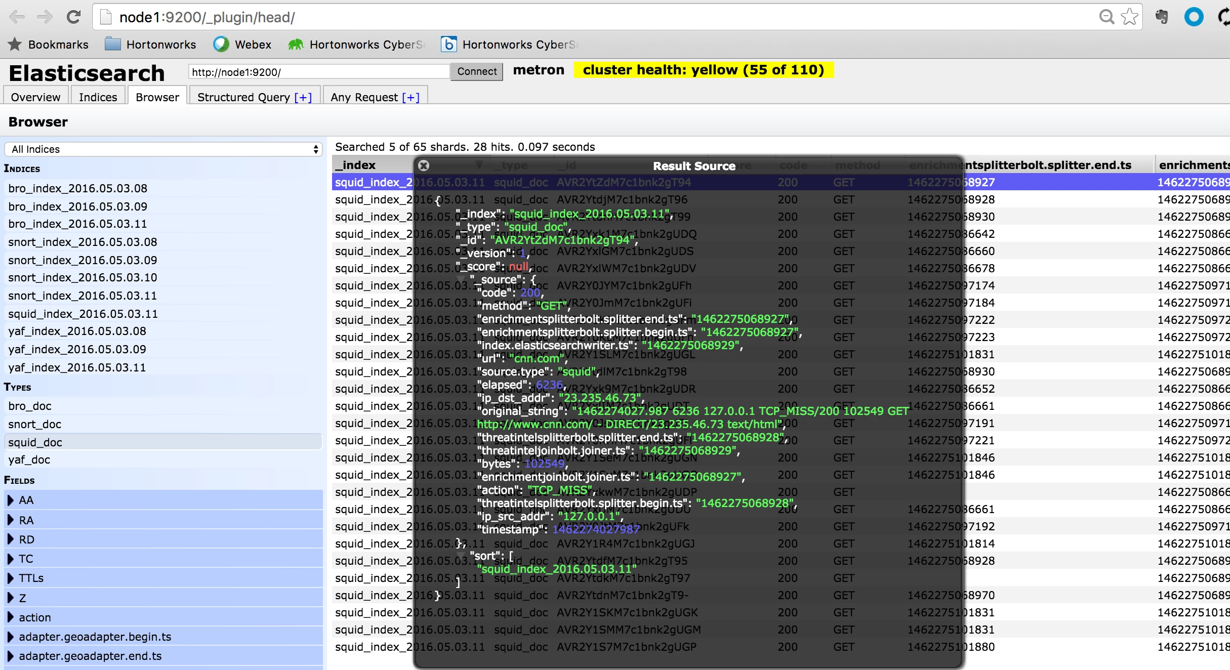

Verify Events are Indexed
By convention the index where the new messages will be indexed is called squid_index_[timestamp] and the document type is squid_doc.
In order to verify that the messages were indexed correctly, we can use the elastic search Head plugin.
  1. Install the head plugin:
/usr/share/elasticsearch/bin/plugin -install mobz/elasticsearch-head/1.x
You should see the message: Installed mobz/elasticsearch-head/1.x into /usr/share/elasticsearch/plugins/head
2. Navigate to elastic head UI: http://node1:9200/_plugin/head/
3. Click on Browser tab and select squid doc on the left panel and then select one of the sample docs. You should see something like the following:

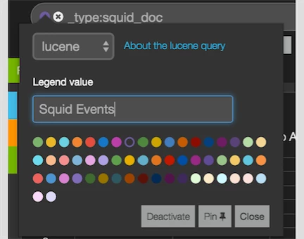

Configure Metron UI to view the Squid Telemetry Events
Now that we have Metron configured to parse, index and persist telemetry events and Nifi pushing data to Metron, lets now visualize this streaming telemetry data in the Metron UI.
  1. Go to the Metron UI.
  2. Add a New Pinned query
    1. Click the + to add new pinned query
    2. Create a query: _type: squid_doc
    3. Click the colored circle icon, name the saved query and click Pin. See below

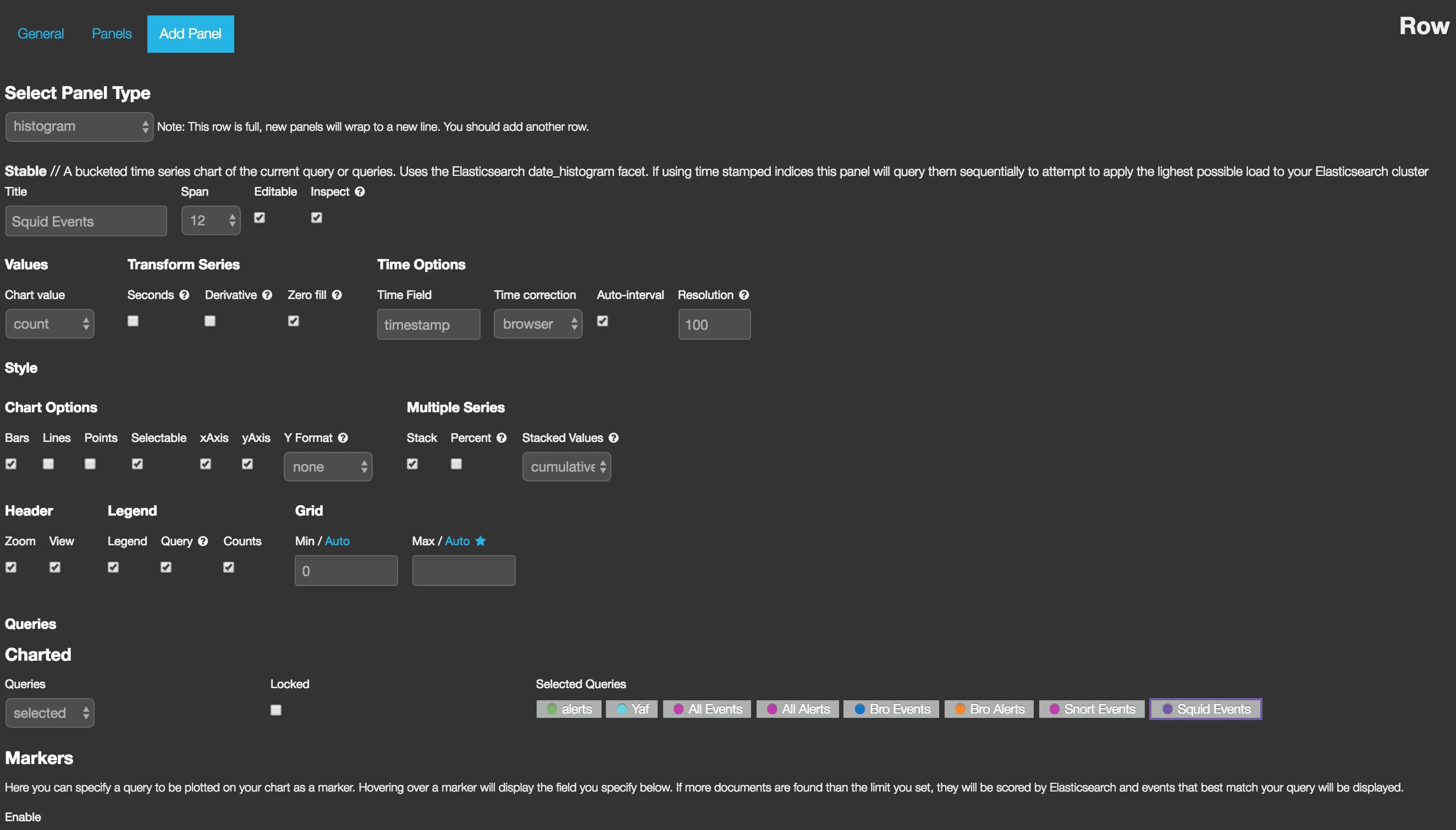

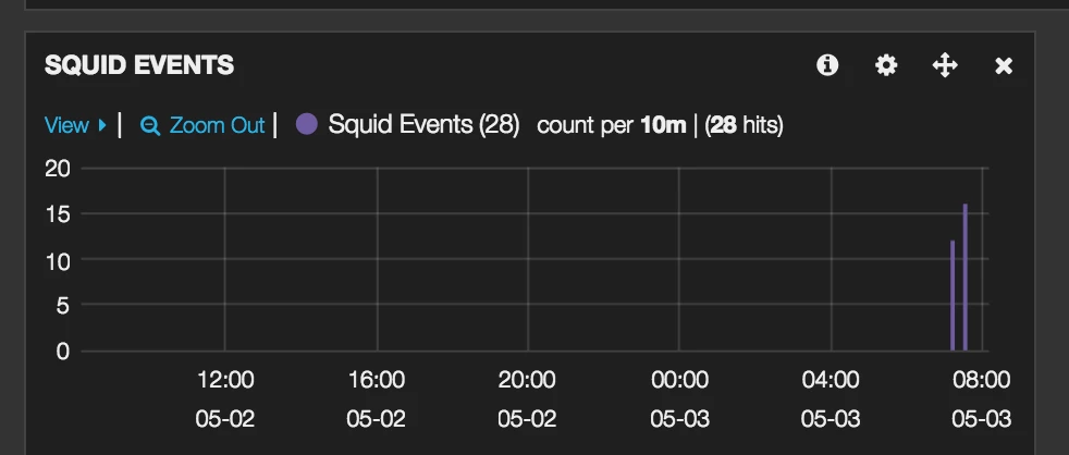

  3. Add a new histogram panel for the Squid events
    1. Click the add add panel + icon
    2. Select histogram panel type
    3. Set title as “Squid Events”
    4. Change Time Field to: timestamp
    5. Configure span to 12
    6. In the queries dropdown select “Selected” and only select the “Squid Events” pinned query
    7. Click Save and should see data in the histogram
  • You should now see the new Squid events

After performing all of the steps in "Step 1: Spin Up Single Node Vagrant VM", Storm is up and running with 4 slots and 4 topologies running. The user is then left with the issue that was described here: no-workers-in-storm-for-squid-topology
Would it make sense to add another sub-step before sub-step 5 that instructs the user to add a port to the "supervisor.slots.ports:"[6700, 6701, 6702, 6703]" found in: metron-deployment/roles/ambari_config/vars/single_node_vm.yml ?

@apsaltis
, Thanks for your comment. I believe you're correct and we need an additional step to add a port. I'm researching the best way to add that port and I will modify that step when I have my results. Thanks for your help.

June 4, 2016
@apsaltis After some research I discovered the easiest way to ensure that Squid is assigned a worker is to kill one or more of the existing topologies. The Storm Supervisor will then assign one of the free workers to Squid. You can kill a topology either in the Storm UI or in the CLI. I will add a step to cover this in the article. Thanks again for your comments.

May 14, 2016
@apsaltis I'm modifying my previous reply. To deploy the new squid parser topology, you do not need to use "sudo" anywhere except at the very beginning of the command string. I tried it twice as is and it worked perfectly both times. Thank you for your feedback though. We really appreciate you taking the time to comment on the instructions so we can improve them.
