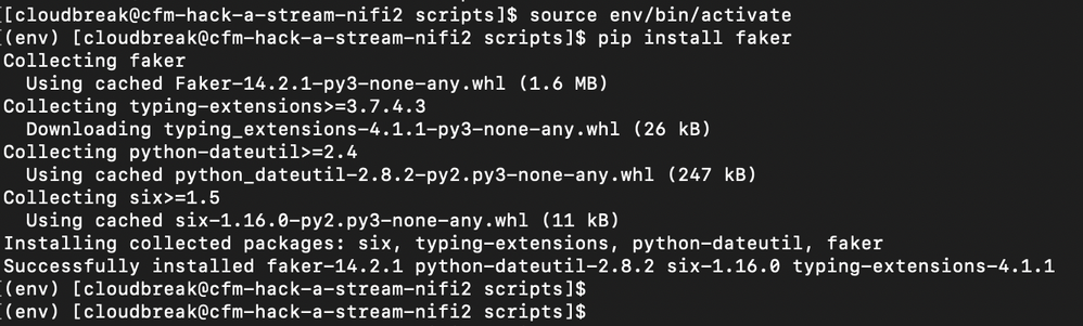

       Step 2 : Activate the Environment and install the package using the following commands
                    source env/bin/activate
               Note : Once the virtual environment is activated you should see you environment name at the start of the command prompt.
          Step 3 : Install the module using the following command
                           pip install faker

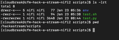

          Step 4 : Once the installation completes, create a shell script(test.sh) with the following content
                                 #!/bin/bash
                                  source /path/to/your-environment/env/bin/activate
                                  python /path/to/your/script/test.py
            My script folder looks something like this:
Important : Make sure the script and the virtual environment folder are accessible by the user which is running NiFi.

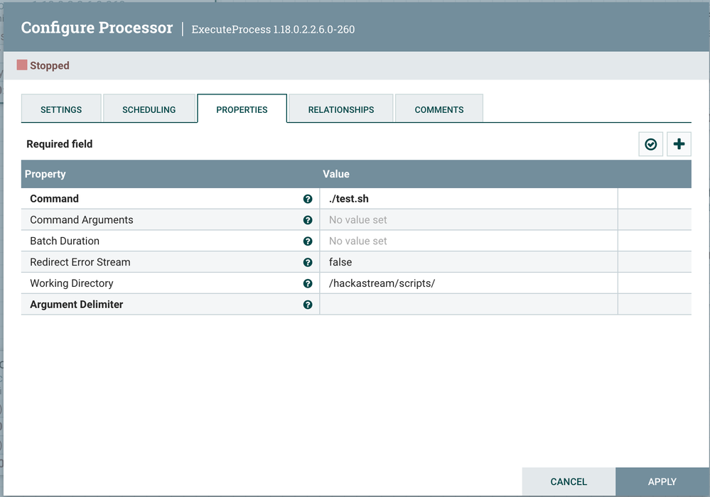

Stage 2 : Configuring the ExecuteProcess processor
            Step 1 : In NiFi, configure the processor in the following way
Your processor will now be able to import the module that you have setup within your python virtual environment
