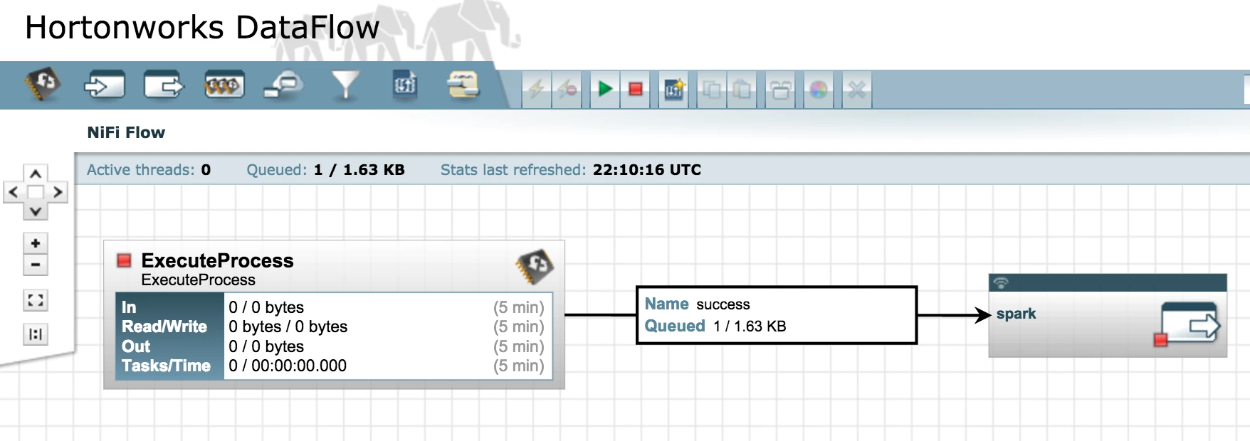

6) Let us build a small flow on NiFi canvas to read app log generated by NiFi itself to feed to spark:
a) Connect to below url in your browser: http://<your_vm_ip>:8090/nifi/

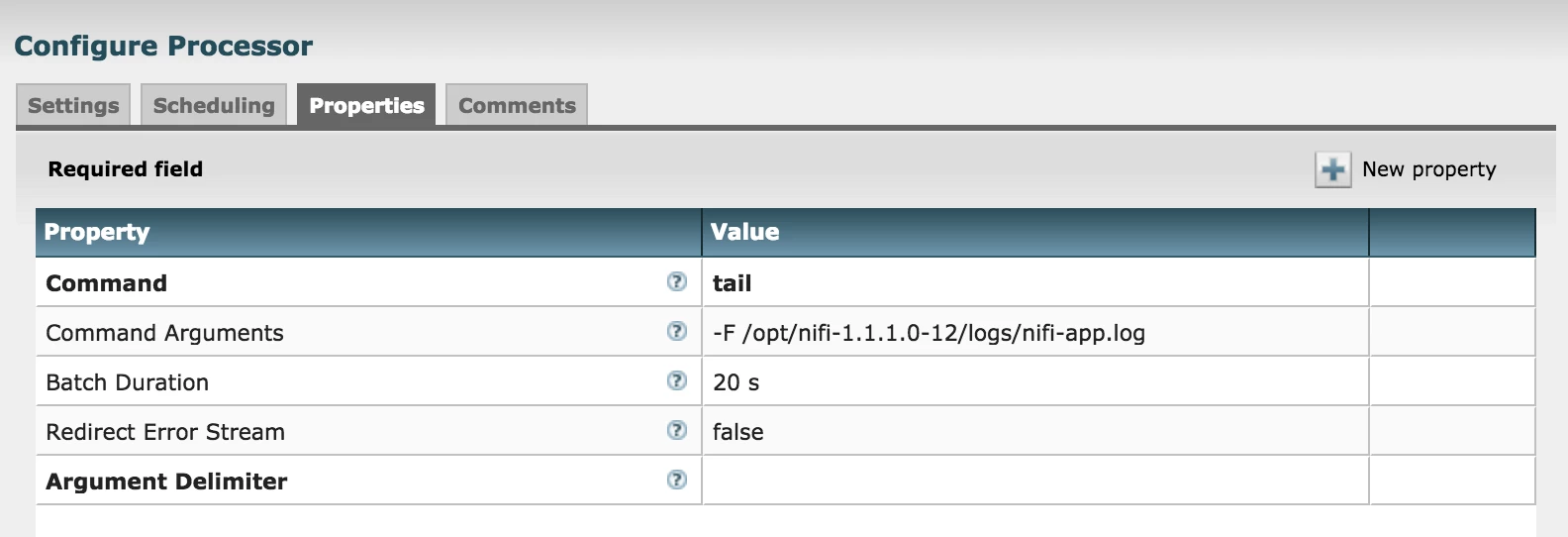

b) Drop an "ExecuteProcess" Processor to canvas [or you can use TailFile Processor] to read lines added to "nifi-app.log". Auto Terminate relationship Failure. The configuration on the processor would look like below:
c) Drop an OutputPort to the canvas and Name it 'spark', Once added, connect "ExecuteProcess" to the port for Success relationship. This simple flow will look like below:

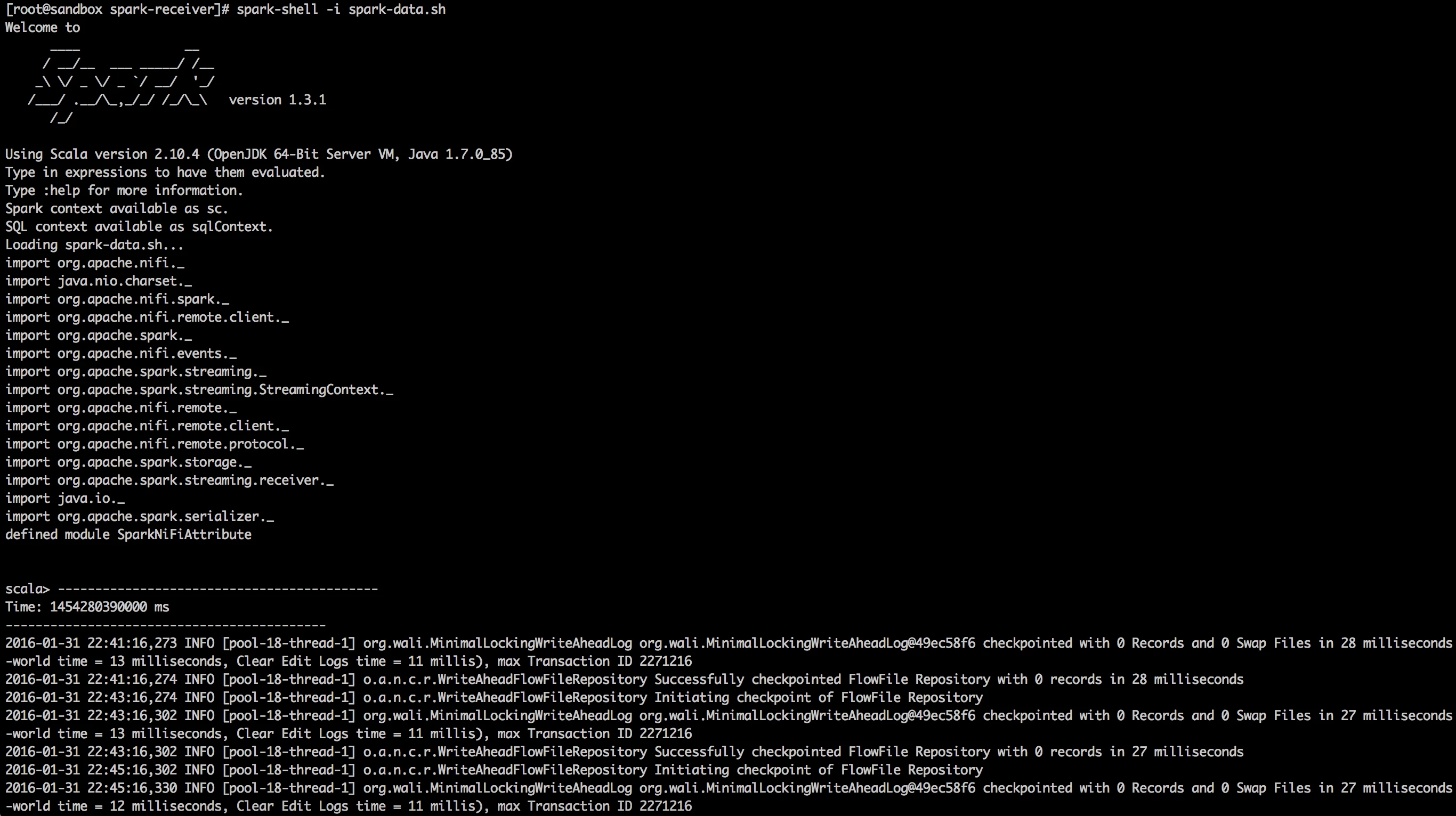

10) Now load the script to spark-shell with below command and start streaming:
# spark-shell -i spark-data.sh
11) In the screenshot below, you can see the NiFi logs being pulled and printed on the console:

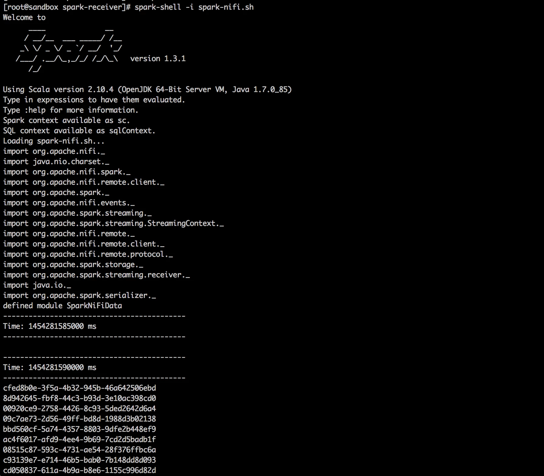

12) Same way we can pull data from NiFi and extract the associated Attributes:
 // Import all the libraries required
import org.apache.nifi._
import java.nio.charset._
import org.apache.nifi.spark._
import org.apache.nifi.remote.client._
import org.apache.spark._
import org.apache.nifi.events._
import org.apache.spark.streaming._
import org.apache.spark.streaming.StreamingContext._
import org.apache.nifi.remote._
import org.apache.nifi.remote.protocol._
import org.apache.spark.storage._
import org.apache.spark.streaming.receiver._
import java.io._
import org.apache.spark.serializer._
object SparkNiFiData {
def main(args: Array[String]) {
        // Build a Site-to-site client config with NiFi web url and output port name
val conf = new SiteToSiteClient.Builder().url("http://localhost:8090/nifi").portName("spark").buildConfig()
        // Set an App Name
val config = new SparkConf().setAppName("Nifi_Spark_Attributes")
        // Create a  StreamingContext
val ssc = new StreamingContext(config, Seconds(5))
        // Create a DStream using a NiFi receiver so that we can pull data from specified Port
val lines = ssc.receiverStream(new NiFiReceiver(conf, StorageLevel.MEMORY_ONLY))
 // Extract the 'uuid' attribute
val text = lines.map(dataPacket => dataPacket.getAttributes.get("uuid"))
text.print()
ssc.start()
ssc.awaitTermination()
SparkNiFiData.main(Array())
13) In the screenshot below, you can see the FlowFile attribute "uuid" being extracted and printed on the console:

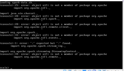

Hello, i got a error after step 10 when run spark-data.sh. It is "nifi is not member of package org.apache". How can i fix this problem? thank you
@Yumin Dong Which version of HDF/NiFi are you using? if the latest one, I hope you downloaded the latest version of dependencies. Let me know.
