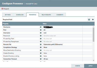

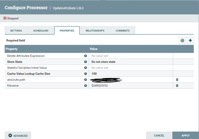

I'm trying this way.
With an UpdateAttribute processor and right after FetchSFTP
I'm trying this way because I need to run Oracle QUERY previously and do some validations
Can it work?

@leandrolinof
I see no reason why using UpdateAttribute to establish the needed path and filename values for FetchSFTP processor would not work.  FetchSFTP has no dependency on using ListSFTP.  ListSFP just serves as a mechanism for obtaining a list of Files from a target SFTp server and recording state.  ListSFTP simply creates a FlowFile with the needed attributes set for each File found on the target.  So if you have another method build that can get set those attributes, then you are good to go.

@MattWho
Thank you very much, this worked perfectly for what I was needing.
