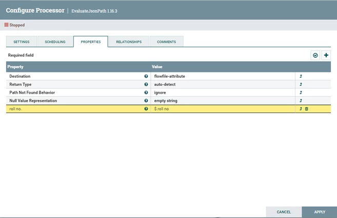

Can someone please help me with it? Thanks

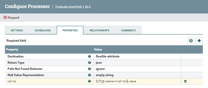

If you want to extract the value (3032) of the name "roll no" into flowfile attribute called "roll no" you can accomplish this with two processors as follows:
1- EvaluateJsonPath:
    roll no = $.[?(@.name=='roll no')].value
    Make sure the Return Type is set to Json since the exrepssion above will return json ["3032"].

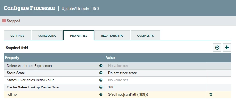

2- Update Attribute : which will extract the actual value from result json above with the following  attribute:   roll no = ${'roll no':jsonPath('$[0]')}
