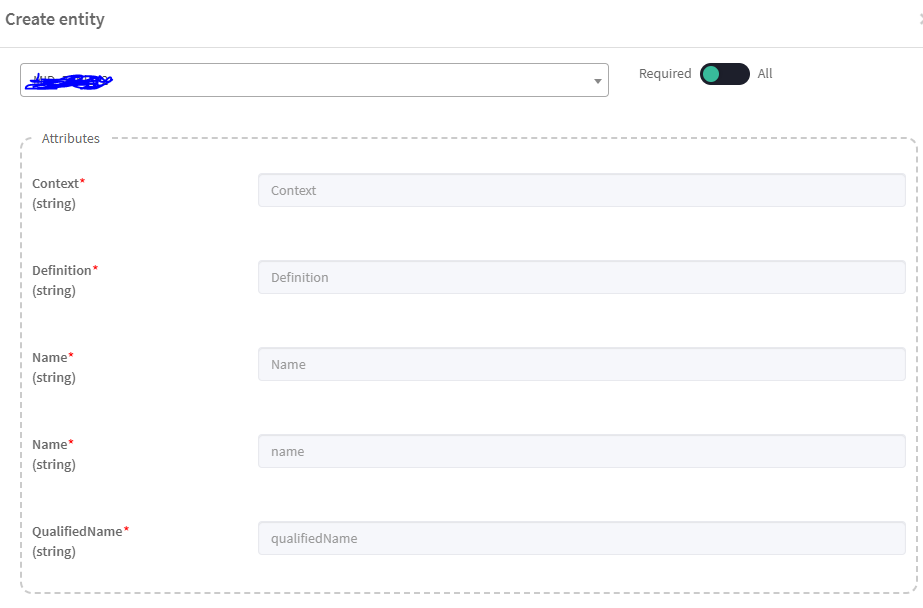

I have created a new entity and I would like to show all the attributes by default while doing the 'Create new entity' process. At present, the UI mask shows only the Required attributes. How can I do this?entity.PNG

Hi @gianluca ,
If you would like to view all the attributes while creating a new entity in the Atlas Web UI, please use the toggle button on the top right in the Create entity window to switch it from "Required" to "All".
