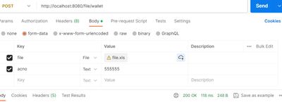

I have have two request formdata param. One param is file which is multipart and another is acno which is string. Here is the postman image:
Postman request is working fine. This postman request, I want to process using Apache Nifi. Here I have tried to use below image in apache nifi:

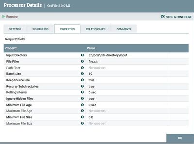

1. GetFile screen :

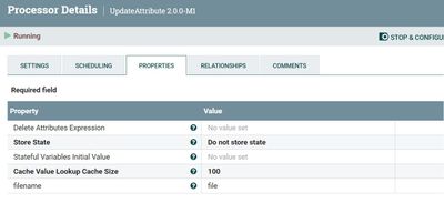

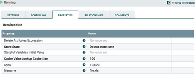

2. Update Attribute screen:

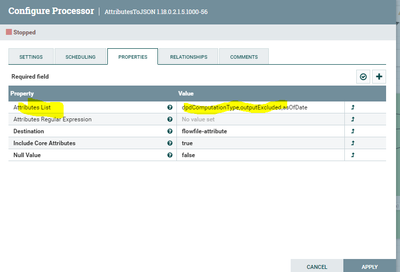

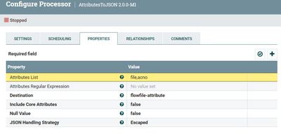

3. AttributeToJson screen:

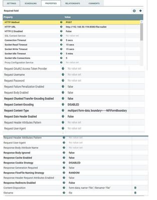

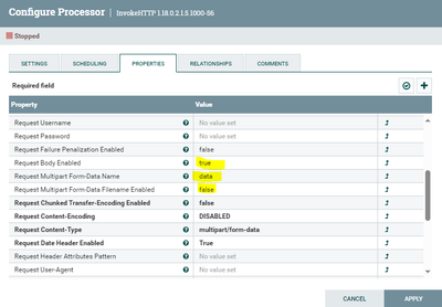

4. InvokeHTTP screen:

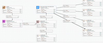

I follow steps above screen --> Getfile->UpdateAtribute->AttributeToJson->InvokHttp

Not sure where you set the acno  parameter , I cant see it in the UpdateAttribute. Make sure the value is available before the invokeHttp as flowfile attribute. Once you have that and you want to send it as  multipart form request you need to add dynamic property with the following format per the documentation (https://nifi.apache.org/docs/nifi-docs/components/org.apache.nifi/nifi-standard-nar/1.17.0/org.apach...
So in your case  the dynamic property will look like the following:
In this case you probably dont need the AttributeToJson processor.

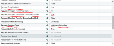

I did a test on a multipart file upload api and it worked for with the following properties:
No need to add dynamic properties for Content-Disposition & Content-Type. There is a property already for the Content-Type called "Request Content-Type".

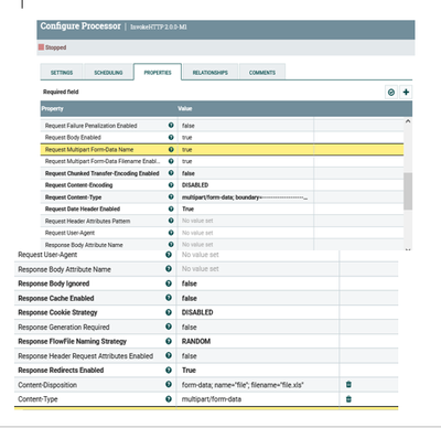

Hello samsal ,
I'm also doing the same thing and I tried with your approach also but still I'm getting the error like
java.lang.IllegalStateException: closed
Can you plz help me in this these are my configuration which i have done
this preview which i got
And the configuration:-
pankajgaikwad_1-1729599611161.pngpankajgaikwad_2-1729599629740.pngpankajgaikwad_3-1729599665666.pngpankajgaikwad_4-1729599683148.pngpankajgaikwad_5-1729599697291.png
and the enitre pipeline

My understanding is the file "file.xls" will be uploaded and the file name is stored under filename attribute (make sure to set the file name and extension correctly in the UpdateAttribute as file.xls) , Also make sure the following properties are set as follows:
Request Body Enabled : true
Request Multipart Form-Data Filename Enabled : true
The later will set the Content-Disposition accordingly based on the filename attribute so you dont have to add as dynamic property.
Hope that helps.

@SAMSALthanks again for your reply.  You describe it clearly. I have updated myfile. but still show file not exist. sorry for disturb you again
Here is the update attribute:
My invokeHttp:
Please help me..
Contributor
Dear Samsal,  thank you very much for providing me your valuable  support. It is working now. You save me full weak...Thanks again

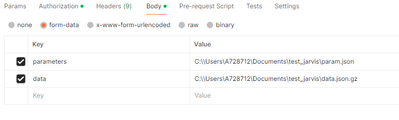

I m sending multipart request from Nifi 1.18, but in my case the 1st part should be binary (gzip) and named (data) and the second part should be json file and named (parameters). this works corretly with post man
but I m not able to do the same thing with Nifi 1.18
