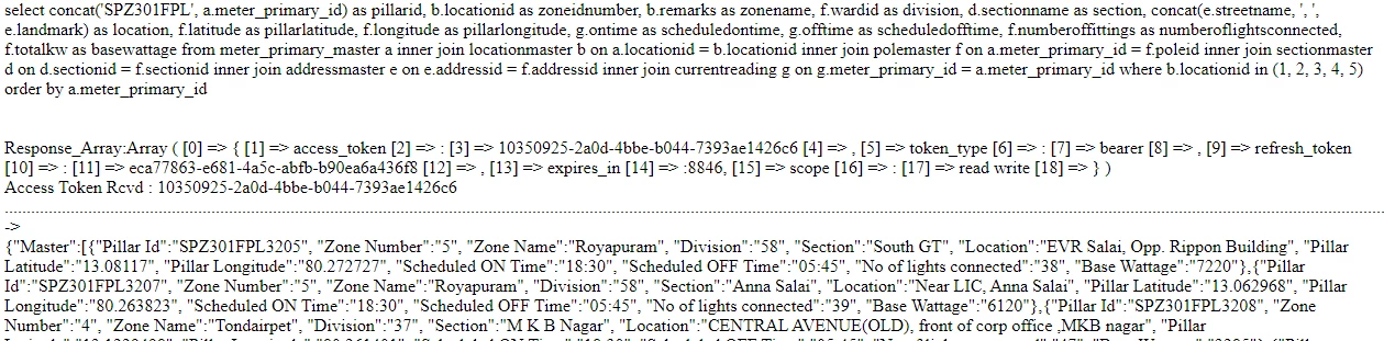

select concat SPZ301FPL , a meter primary id as pillarid, b locationid as zoneidnumber, b remarks as zonename, f wardid as division, d sectionname as section, concat e streetname, , , e landmark as location, f latitude as pillarlatitude, f longitude as pillarlongitude, g ontime as scheduledontime, g offtime as scheduledofftime, f numberoffittings as numberoflightsconnected, f totalkw as basewattage from meter primary master a inner join locationmaster b on a locationid b locationid inner join polemaster f on a meter primary id f poleid inner join sectionmaster d on d sectionid f sectionid inner join addressmaster e on e addressid f addressid inner join currentreading g on g meter primary id a meter primary id where b locationid in 1, 2, 3, 4, 5 order by a meter primary id br br br Response Array:Array 0 { 1 access token 2 : 3 10350925 2a0d 4bbe b044 7393ae1426c6 4 , 5 token type 6 : 7 bearer 8 , 9 refresh token 10 : 11 eca77863 e681 4a5c abfb b90ea6a436f8 12 , 13 expires in 14 :9348, 15 scope 16 : 17 read write 18 } br Access Token Rcvd : 10350925 2a0d 4bbe b044 7393ae1426c6 br Procesing br {"Master": {"Pillar Id":"SPZ301FPL3205", "Zone Number":"5", "Zone Name":"Royapuram", "Division":"58", "Section":"South GT", "Location":"EVR Salai, Opp Rippon Building", "Pillar Latitude":"13 08117", "Pillar Longitude":"80 272727", "Scheduled ON Time":"18:30", "Scheduled OFF Time":"05:45", "No of lights connected":"38", "Base Wattage":"7220"},
I have api that gives the above content want only the Braces value & delete rest
please help
hope Im clear
Tried - EvaluateJSONPath error - not a valid JSON Content
Tried - XML - did not start & end properly

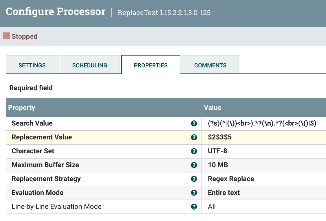

@J0sh ,
If you use a ReplaceText with the following settings it will clean up the garbage in your flowfiles:
Search Value:      (?s)(^|(\})<br>).*?(\n).*?(<br>(\{)|$)
Replacement Value: $2$3$5
This file, though, has not 1 JSON, but 8 different JSON fragments. So the resulting flowfile will still have 8 lines, each with a valid JSON. You must use a SplitText process to separate those into 8 different flowfiles before applying the EvaluateJSONPath.

@J0sh ,
