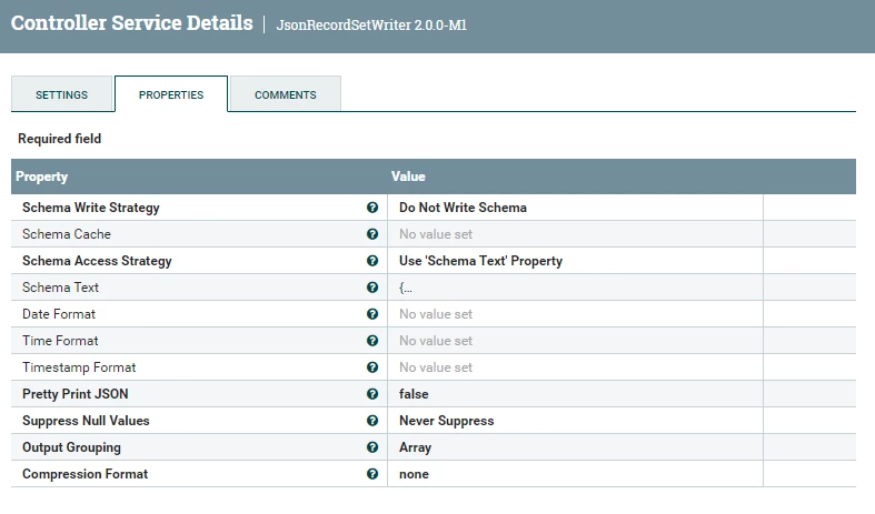

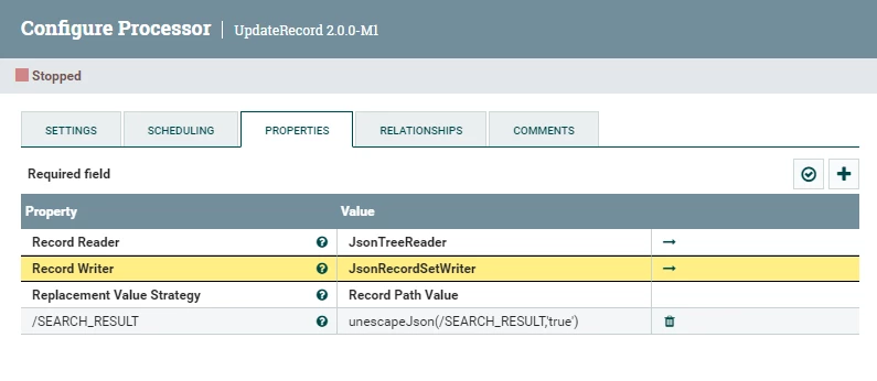

Another option is to use the UpdateRecod with an Avro schema in the JsonRecordSetWriter that reflects the actual json structure coming out of the ExecuteSQL
The UpdateRecord will look like this:
The JsonRecorSetWriter looks like this:
The AvroSchema provided in the ShemaText property is the following:

Hi @SAMSAL
when I try in my local with the schema text that you provided.
I am seeing this error:
UpdateRecord[id=5e779eb4-018c-1000-b9ea-047535bdcfb5] Failed to write MapRecord[{SEARCH_RESULT=unescapeJson(/SEARCH_RESULT, 'true')}] with reader schema ["SEARCH_RESULT" : "STRING"] and writer schema {"type":"record","name":"nifi","namespace":"nifi.com","fields":[{"name":"SEARCH_RESULT","type":{"type":"record","name":"SEARCH_RESULT","fields":[{"name":"requestId","type":"string"},{"name":"responseData","type":{"type":"array","items":{"type":"record","name":"responseData","fields":[{"name":"searchKey","type":"string"},{"name":"data","type":{"type":"array","items":{"type":"record","name":"data","fields":[{"name":"firstName","type":"string"},{"name":"lastName","type":"string"}]}}}]}}}]}}]} as a JSON Object due to org.apache.nifi.serialization.record.util.IllegalTypeConversionException: Cannot convert value [unescapeJson(/SEARCH_RESULT, 'true')] of type class java.lang.String to Record for field SEARCH_RESULT
    at
Input that I am using is: [{
"SEARCH_RESULT": "{ \"requestId\": \"203680\", \"responseData\": [ { \"searchKey\": \"cardNumber\", \"data\": [ { \"firstName\": \"Martin\", \"lastName\": \"Garry\" }, { \"firstName\": \"Martin\", \"lastName\": \"Garry\"}, { \"firstName\": \"Martin\", \"lastName\": \"Garry\", } ] } ] }"
also tried with
org.apache.nifi.serialization.record.util.DataTypeUtils.toRecord(DataTypeUtils.java:444)
Translate
SAMSAL
Platinum ⭐️⭐️⭐️
December 12, 2023
Can you post screenshot of the UpdateRecord processor configuration? Also you have to be careful with the provided input because there is an extra comma after last Garry value which makes the json invalid.
