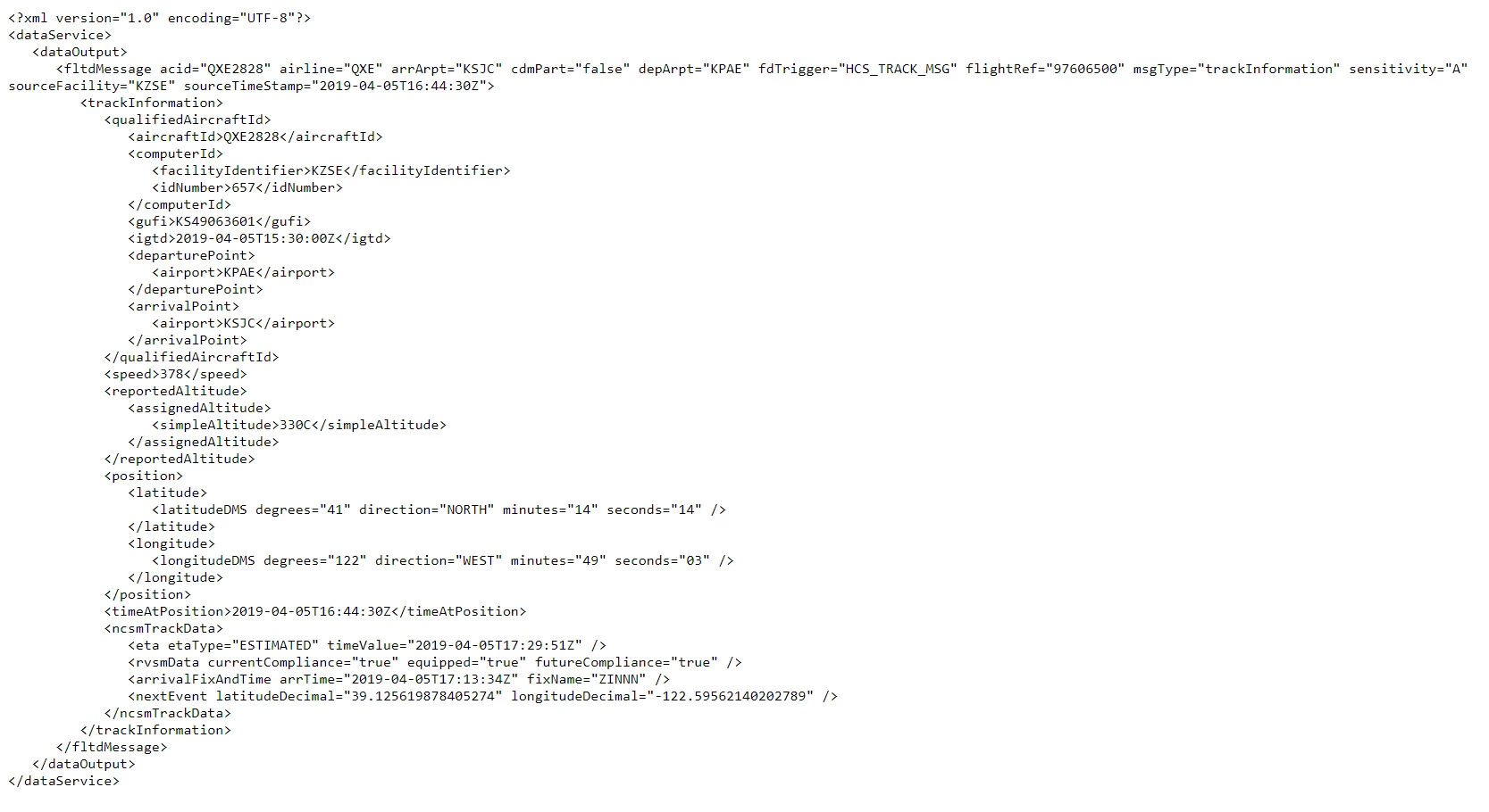

Can someone please help me with the AVRO spec for this XML
The XML that I have is as follows:
<?xml version="1.0" encoding="UTF-8"?>
<dataService>   <dataOutput>      <fltdMessage acid="QXE2828" airline="QXE" arrArpt="KSJC" cdmPart="false" depArpt="KPAE" fdTrigger="HCS_TRACK_MSG" flightRef="97606500" msgType="trackInformation" sensitivity="A" sourceFacility="KZSE" sourceTimeStamp="2019-04-05T16:44:30Z">         <trackInformation>            <qualifiedAircraftId>               <aircraftId>QXE2828</aircraftId>               <computerId>                  <facilityIdentifier>KZSE</facilityIdentifier>                  <idNumber>657</idNumber>               </computerId>               <gufi>KS49063601</gufi>               <igtd>2019-04-05T15:30:00Z</igtd>               <departurePoint>                  <airport>KPAE</airport>               </departurePoint>               <arrivalPoint>                  <airport>KSJC</airport>               </arrivalPoint>            </qualifiedAircraftId>            <speed>378</speed>            <reportedAltitude>               <assignedAltitude>                  <simpleAltitude>330C</simpleAltitude>               </assignedAltitude>            </reportedAltitude>            <position>               <latitude>                  <latitudeDMS degrees="41" direction="NORTH" minutes="14" seconds="14" />               </latitude>               <longitude>                  <longitudeDMS degrees="122" direction="WEST" minutes="49" seconds="03" />               </longitude>            </position>            <timeAtPosition>2019-04-05T16:44:30Z</timeAtPosition>            <ncsmTrackData>               <eta etaType="ESTIMATED" timeValue="2019-04-05T17:29:51Z" />               <rvsmData currentCompliance="true" equipped="true" futureCompliance="true" />               <arrivalFixAndTime arrTime="2019-04-05T17:13:34Z" fixName="ZINNN" />               <nextEvent latitudeDecimal="39.125619878405274" longitudeDecimal="-122.59562140202789" />            </ncsmTrackData>         </trackInformation>      </fltdMessage>   </dataOutput>
</dataService>

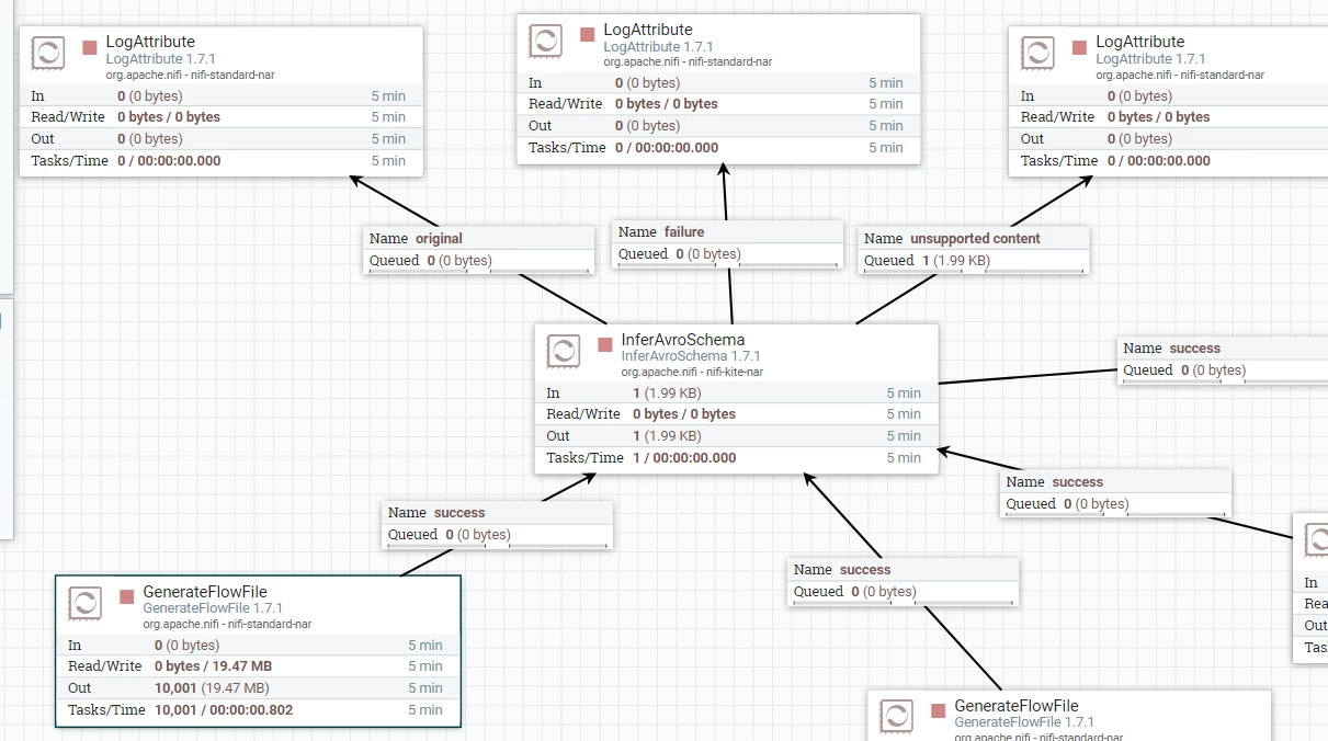

I'd like to generate the AVRO spec for this so that I can use ConvertRecord with an XMLReader. Is there an easy way to do this?
The InferAvroSchema processor does not seem to support this structure, as can be seen by the "unsupported content" in the following. I belive this processor only supports csv and json.
So I think I need to find another means to generate the AVRO schema.

I've tried 1.9.2. Sure enough the XMLRecordReader works with message inference. Using this as part of ConvertRecord allowed me to easily convert from XML to JSON (avoding the use of TransformXML with an xslt sheet).
