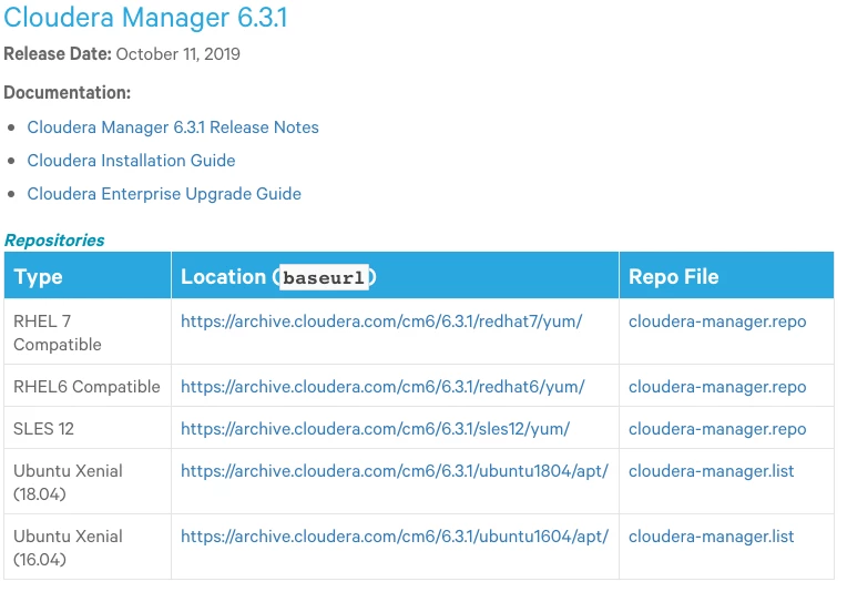

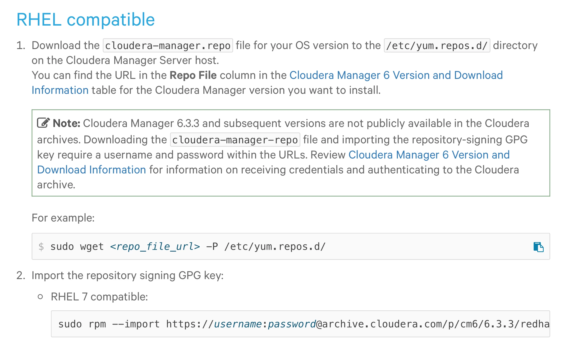

Hi, as we all know CDH 6.3.3 and subsequent versions are not available anymore under "Express licensing" model. Yet, I was in the process of setting up a 6.3.1 installation and apparently this is not possible, because a valid authentication (enterprise) is required. What am I doing wrong?
Below, a screenshot from the Installation Guide:
But when I try to import the 6.3.1 Repository (WITHOUT Username and Password as stated on the documentation itself for version < 6.3.3 I get the following error:
# rpm --import https://archive.cloudera.com/p/cm6/6.3.1/redhat7/yum/RPM-GPG-KEY-cloudera
curl: (22) The requested URL returned error: 401 Authentication required
errore: https://archive.cloudera.com/p/cm6/6.3.1/redhat7/yum/RPM-GPG-KEY-cloudera: lettura importazione fallita(2).
What am I doing wrong? @Cloudera1 Is this a mistake I'm committing or is it a problem with Cloudera implementing their policies in a wrong way?

Hello FrozenWave,
Please give the following command a try:
# rpm --import https://archive.cloudera.com/cm6/6.3.1/redhat7/yum/RPM-GPG-KEY-cloudera
The reason you were having issues are that the repository URLs changed for version 6.3.3 and later as referenced here:
https://docs.cloudera.com/documentation/enterprise/6/release-notes/topics/rg_cm_6_version_download.html
The correct base URL for CM 6.3.1 is:
Versus the URL you were trying to use, which requires authentication:
I hope this helps!
