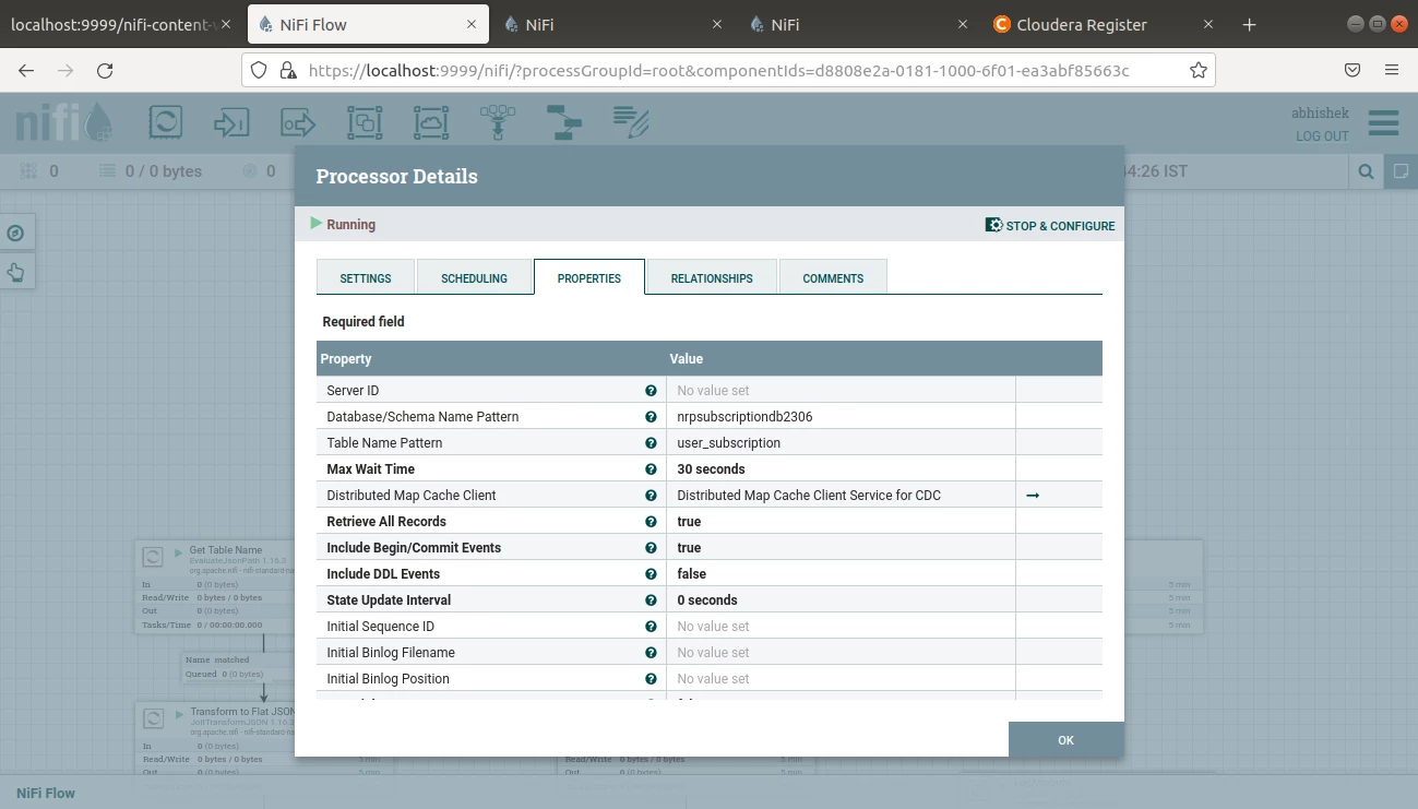

Hi All,
I am getting error when I restart the NiFi server and run the CaptureChangeMySql processor or re-configure any processor and start the processor. It works fine when I creates CaptureChangeMySql processor and run it. When I restart the server this I start getting below error. It works fine again when processor is recreated freshly.
Any Idea how I can fix this issue.
2022-07-07 15:10:58,307 ERROR [Timer-Driven Process Thread-8] o.a.n.c.m.processors.CaptureChangeMySQL CaptureChangeMySQL[id=d7f0536f-0181-1000-db94-5950dddc0439] Processing failed
org.apache.nifi.processor.exception.ProcessException: java.io.IOException: COMMIT event received while not processing a transaction (i.e. no corresponding BEGIN event). This could indicate that your binlog position is invalid.
