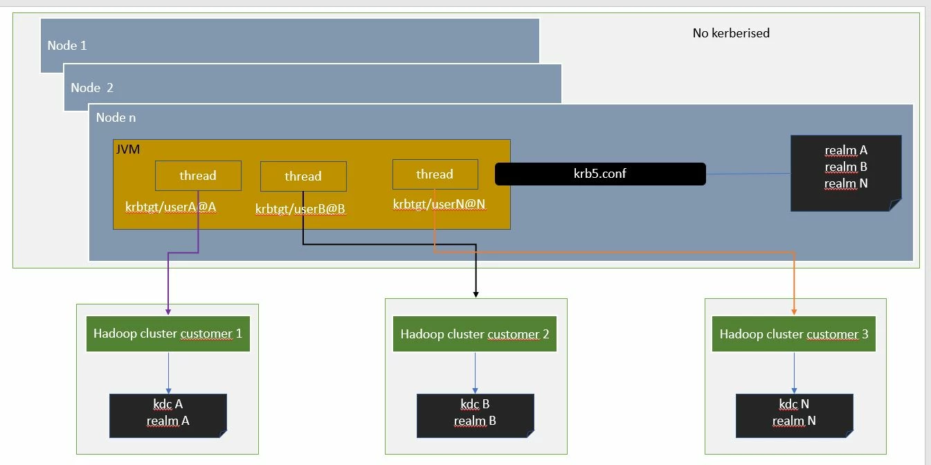

I'm working to a new feature with an existing nifi cluster to provide a new service to add an interface with serveral kerberized HDP Cluster.
I would like to know if a single Nifi cluster can use several realms in the same krb5 file.
Reading official documentation, nifi can do it (https://nifi.apache.org/docs/nifi-docs/html/administration-guide.html#kerberos_properties) : " If necessary the krb5 file can support multiple realms."

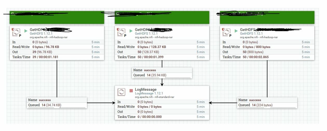

It seems ok but because at this time I have no way to have several hadoop cluster for testing (to notice : my cluster is working already with one kerberized cluster hadoop ), is anybody can confirm or reject this design: one cluster Nifi with different realms to communicate with multiple kerberized hdp cluster.
Thanks for your help and as soon as I have several kerberized cluster hadoop for testing, I will update this article.
