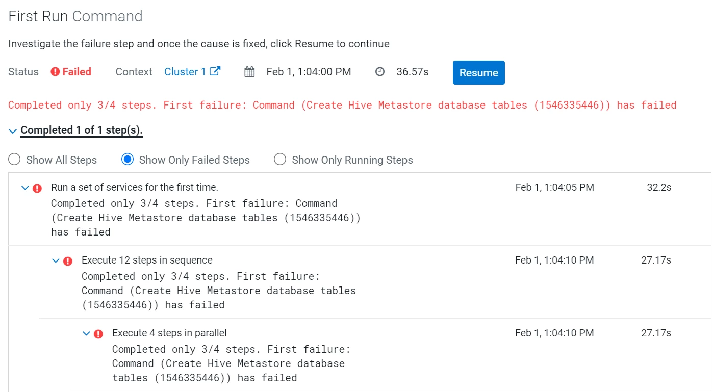

Hi Team, This is Prsanna. I'm new to CDP and trying to create a CDP Trail base cluster for testing purposes, but while creating it I'm facing an error in the Hive Service. Please suggest a possible solution.
Please refer to the screenshot and log file.

Master Collaborator
It appears that the Hive Metastore (HMS) is unable to establish a connection with the BackendDB, possibly due to an incorrect hostname or BackendDB configuration within the Hive service. Please validate the BackendDB configurations and attempt to start the service again.
