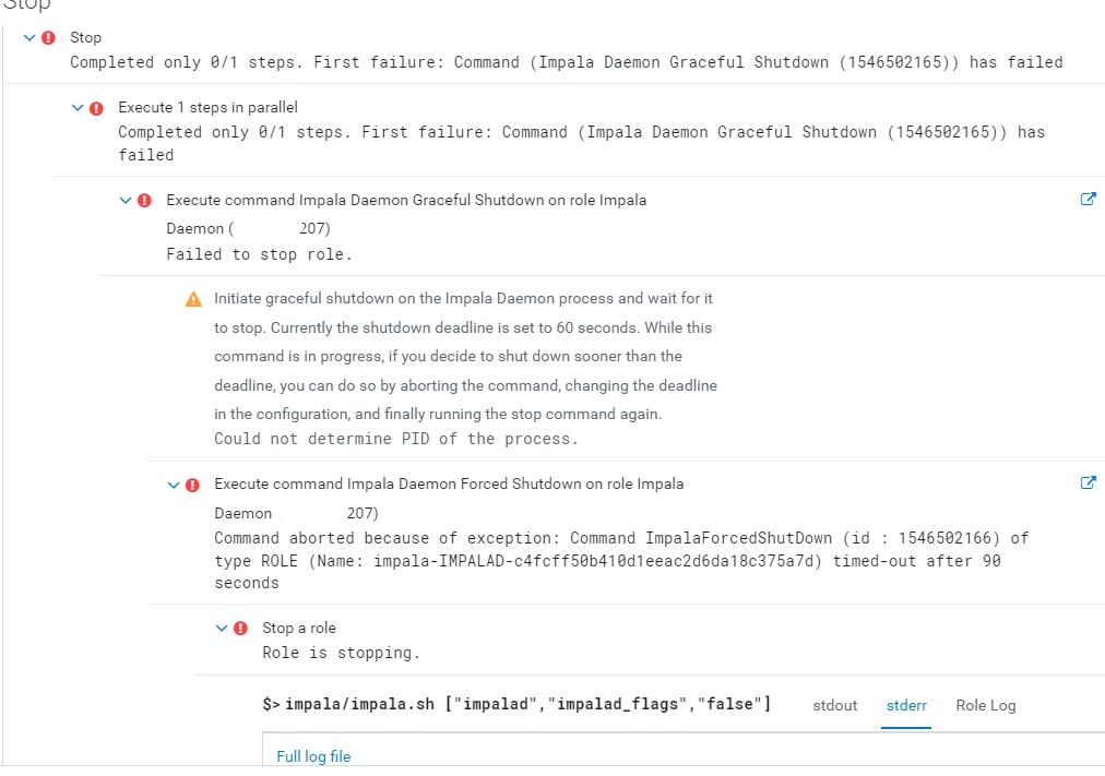

Hi Community,
I am unable to stop or start some Cloudera services.
Cloudera version: 7.11.3
CDP Version: 7.1.7 SP3
Below is the type of error I get while trying to stop (e.g) impala daemon from the Cloudera Manager console.

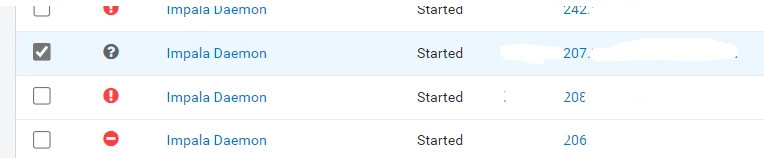

On the UI, it shows the status of the service is unknown as shown below. As you can see, the host 207 has a question mark in its status column, which signifies unknown status.

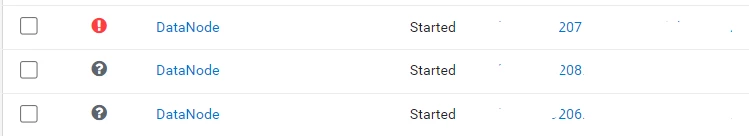

Also, for other host (206, 208), the hdfs datanode has the same issue as that of the impala daemon.
Apart from the impala daemon and hdfs datanode instances, I get the same issue on hue load balancer instance.
Everything was fine a few days ago until yesterday. I have tried restarting the cloudera-scm-supervisord and the cloudera-scm-agent but no luck.
Below is the cloudera-scm-agent.log error I get for all the hosts on which those services are running. It's like nothing else in the cloudera-scm-agent.log apart from the following error.

Does the below process folder and the file inside of it exist? The ERROR is file not found.
[12/Nov/2024 06:03:16 +0000] 1559 __run_queue process ERROR Error creating marker /var/run/cloudera-scm-agent/process/1546503323-hbase-REGIONSERVER/process_timestamp
Traceback (most recent call last):
File "/opt/cloudera/cm-agent/lib/python3.8/site-packages/cmf/process.py", line 1302, in mark_orphan
f = open(marker, 'w')
FileNotFoundError: [Errno 2] No such file or directory: '/var/run/cloudera-scm-agent/process/1546503323-hbase-REGIONSERVER/process_timestamp'
Try to restart cloudera-scm-agent service and then restart RegionServer from CM. If it still doesn't work could you please try the workarounds again?

Thanks for getting back.
The process_timestamp isn't there. It's not available on other running processes too.
I had tried the work around, it didn't work, but I will give it another go.
Another thing is the soft link for RegionServer process does not exist in /var/run/cloudera-scm-agent/supervisor/include directory.
Translate
