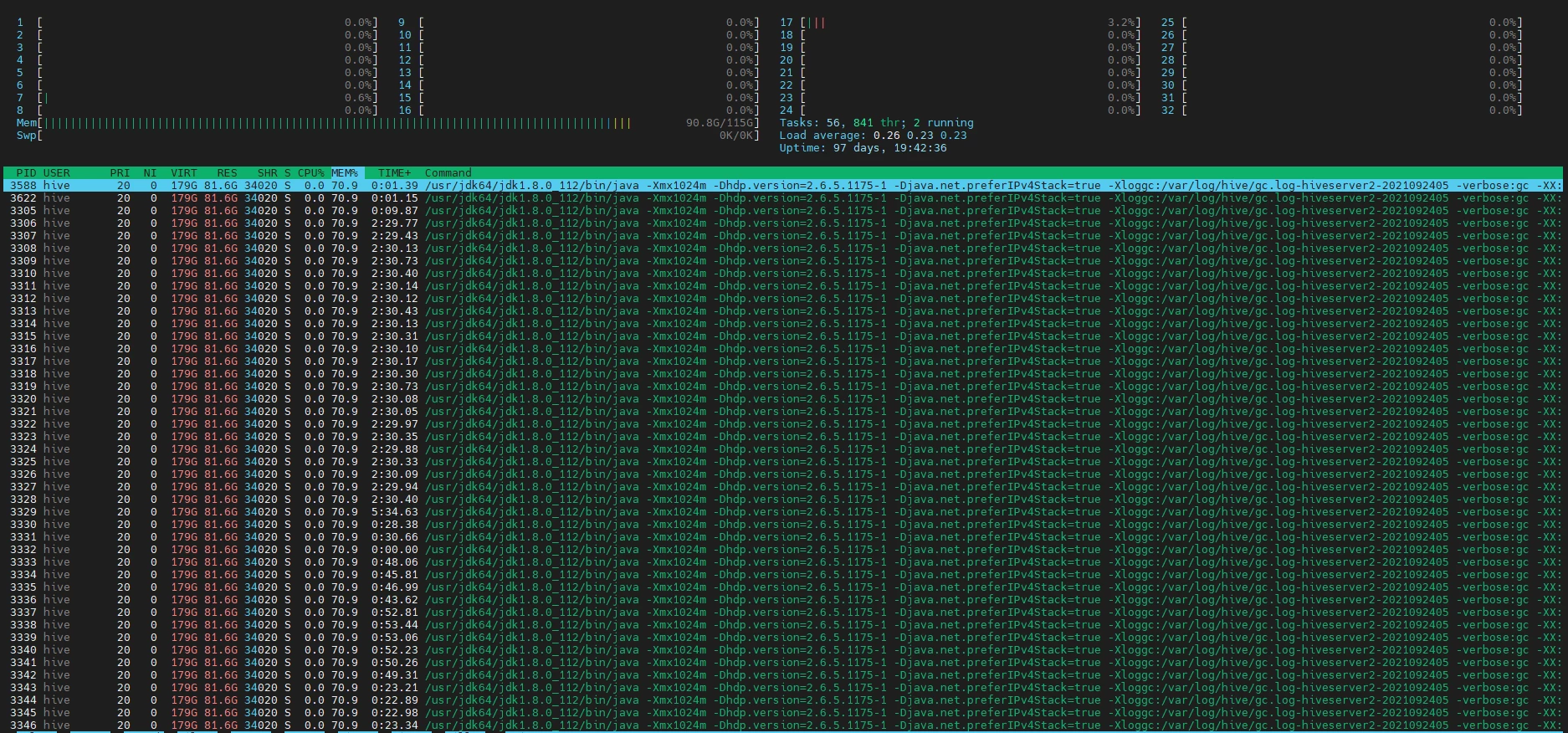

htop give the bellow view
Why all these process are created ? How to reduce memory usage ?

@enirys htop lists every single thread as a separate process. Every individual connection to HS2 and HMS shows up as different processes. So, you do not need to worry about that.
As you say, you have 3 hiveserver2 nodes, see if you could reduce heap size of the hiveserver2.
You could also lower 'hive.server2.thrift.max.worker.threads' so, it does not spin up too many threads in a single hs2 node. Make sure that your workload is getting distributed across HS2s.
